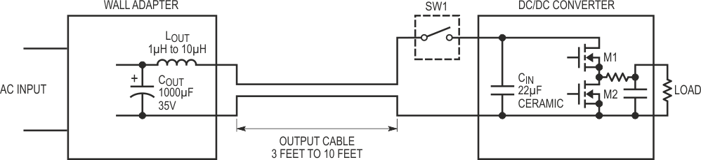

Building the test circuit
To illustrate the problem, a typical 24 V wall adapter used in notebook computer applications was connected to the input of a typical notebook computer DC/DC converter. The DC/DC converter used was a synchronous buck converter that generates 3.3 V from a 24 V input.
The block diagram of the test setup is shown in Figure 1. The inductor LOUT represents the lumped equivalent inductance of the lead inductance and the output EMI filter inductor found in some wall adapters. The output capacitor in the wall adapter is usually on the order of 1000 µF; for our purposes, we can assume that it has low ESR – in the 10 mΩ to 30 mΩ range. The equivalent circuit of the wall adapter and DC/DC converter interface is actually a series resonant tank, with the dominant components being LOUT, CIN and the lumped ESR (the lumped ESR must include the ESR of CIN, the lead resistance and the resistance of LOUT).
Figure 1. Block diagram of wall adapter and portable device connection.
The input capacitor, CIN, must be a low ESR device, capable of carrying the input ripple current. In a typical notebook computer application, this capacitor is in the range of 10 µF to 100 µF. The exact capacitor value depends on a number of factors but the main requirement is that it must handle the input ripple current produced by the DC/DC converter. The input ripple current is usually in the range of 1 A to 2 A. Therefore, the required capacitors would be either one 10 µF to 22 µF ceramic capacitor, two to three 22 µF tantalum capacitors or one to two 22 µF OS-CON capacitors.
Turning on the switch
When switch SW1 in Figure 1 is turned on, the mayhem starts. Since the wall adapter is already plugged in, there is 24 V across its low impedance output capacitor. On the other hand, the input capacitor CIN is at 0 V potential. What happens from t = 0s is pretty basic. The applied input voltage will cause current to flow through LOUT. CIN will begin charging and the voltage across CIN will ramp up toward the 24 V input voltage. Once the voltage across CIN has reached the output voltage of the wall adapter, the energy stored in LOUT will raise the voltage across CIN further above 24 V. The voltage across CIN will eventually reach its peak and will then fall back to 24 V. The voltage across CIN may ring for some time around the 24 V value. The actual waveform will depend on the circuit elements.
