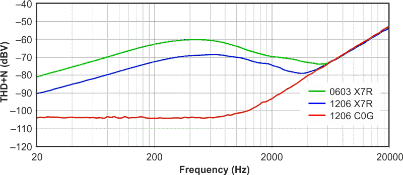

THD+N measurements were made on the filter circuit for a 1 Vrms signal over the frequency range of 20 Hz to 20 kHz with a measurement bandwidth of 500 kHz. Figure 2 shows the measured THD+N performance of the circuit in dB relative to 1 Vrms for different capacitor types. MLCCs of the C0G dielectric type in 1206 packages deliver exceptional performance: the measured THD+N in the filter’s pass-band is at the noise floor of the measurement system. C0G capacitors in 0805 packages were also tested and provide the exact same level of performance, and were removed from the graphs for simplicity. The increase in THD+N above the filter’s corner frequency is expected as the filter’s attenuation decreases the ratio of the signal’s amplitude to the noise floor.

By changing the capacitors to X7R types in 1206 packages, an immediate degradation of the circuit’s performance is observed. The THD+N was increased by a minimum of 15 dB at 20 Hz, and peaks in the region between 400 and 800 Hz where a 35 dB increase in THD+N is measured. Moving to X7R capacitors in smaller 0603 packages further increases THD+N by an additional 10 dB over much of the spectrum. Because the op amp and resistors in the filter are unchanged across all tests, the increased THD+N numbers must be the result of additional harmonics produced by the X7R capacitors in the circuit’s output signal.

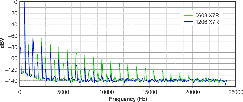

Figure 3 shows the spectrum of a 500 Hz sine wave taken at the filter’s output when 0603 and 1206 X7R capacitors are used. The spectrum shows a large number of fundamental harmonics, with odd order harmonics being dominant. It may be surprising that when the circuit is constructed with 0603 X7R capacitors, harmonics above 20 kHz are observed for a 500 Hz input signal.

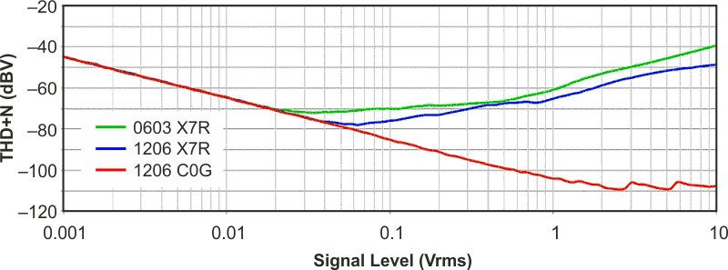

Faced with the task of tracking down the source of high levels of distortion, it may not be immediately intuitive to an engineer whether an integrated circuit or passive components are at fault. One method to determine the dominant source of distortion is to measure the circuit’s THD+N over a wide range of signal levels (Figure 4). In Figure 1 the THD+N of the Sallen-Key filter is displayed for a 500 Hz fundamental with a signal level from 1 mVrms to 10 Vrms. When the circuit was constructed with C0G capacitors, the THD+N decreased for increasing signal levels, eventually reaching the noise floor of the measurement system at a 2 Vrms signal level.

The line’s negative slope indicates that the circuit noise, due to the op amp and resistors, is the dominant factor in the THD+N calculation. In this case, the measured THD+N decreases with increasing signal levels because the signal voltage ratio to the noise voltage is improved. Conversely, non-linearities in passive components are exacerbated at higher signal levels and should cause a rising trend in distortion for increasing signal levels. This is confirmed when the capacitors in the filter circuit are replaced with those of the X7R type. X7R capacitors in 0603 packages show rising distortion beginning at signal amplitudes of 20 mVrms. X7R capacitors in 1206 packages exhibited similar behavior with the rising trend in distortion beginning at 40 mVrms. Thus, if a circuit exhibits a rising trend in distortion with increasing signal levels, passive component (resistors or capacitors) are most likely the dominant limitation of the circuit’s performance.

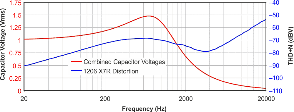

Because passive component distortion increases with higher signal levels, it follows that filter circuit distortion should be greatest when the capacitors experience maximum applied voltage. The AC transfer characteristic analysis in Texas Instruments’ free SPICE simulator, Tina-TI™, can be used to plot the voltage across components in a circuit as a function of frequency. Figure 5 shows the combined voltages across capacitors C1 and C2 over the frequency range from 20 Hz to 20 kHz, as well as the filter’s THD+N for X7R capacitors in 1206 packages. The individual voltages across capacitors C1 and C2 are combined using a root sum of squares method and is at a maximum at approximately 600 Hz. Figure 5 illustrates that this peak in capacitor voltage strongly correlates to the maximum point of distortion and is a very good indicator that the capacitors are the source of excess distortion in the filter’s output. Some misalignment between the two measurements may be present, if the two capacitors generate unequal amounts of distortion. This analysis can be furthered by determining the signal gain from each capacitor.
