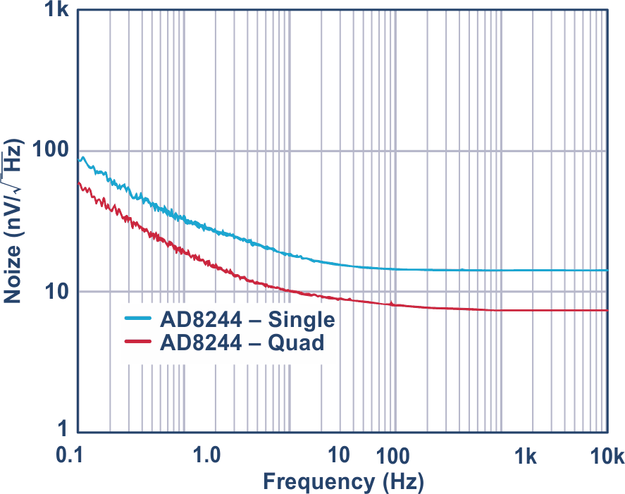

The Figure 2 plot is the comparison of the noise performance of a normal single-channel buffer and the new AD8244 buffer utilizing four channels in parallel.
| Figure 2. | The performance of the new AD8244 buffer: noise is ½ of normal buffer. |
