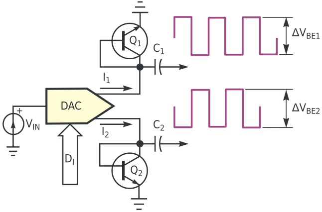

expressed in microvolts. Setting the current ratio IHIGH/ILOW = 10 results in ΔV of approximately 200 µV per degree. The key issue in the practice al implementation of the idea is to switch current with a highly stable IHIGH/ILOW ratio, which you can do by using a number of discrete components. This Design Idea suggests a digitally controlled and integrated approach (Figure 1).
| Figure 1. | The DAC modulates transistors Q1 and Q2 with its two current outputs; ΔVBE is a linear function of absolute temperature. |
The current switching with a stable IHIGH/ILOW ratio, comes from a DAC with current outputs. The typical DAC has two current outputs – a direct I1 and a complementary I2. These outputs allow for simultaneous dual-channel temperature measurements. The current ratio IHIGH/ILOW is a function of the input digital code, DI; you could program this code using a microcontroller. Obviously, you can use the circuit for single-channel temperature measurements, by simply ignoring the second output. If you need more than two channels, then use additional DACs or use a multiphase DAC (Reference 5).

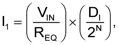

The circuit in Figure 1 works as follows: The output currents, I1 and I2, are functions of the input digital code, DI, and the input voltage, VIN :
and
where REQ is the equivalent transfer resistance of the DAC, and DI is the decimal equivalent of the input binary code.
The full measurement cycle consists of two phases, switching codes from D1 to D2. Assuming D1 > D2, then the current ratio IHIGH/ILOW for output I1 is equal to D1/D2. The current ratio for the second output I2 is equal to
For a 10-bit DAC (N = 10), choosing D1 = 931 and D2 = 93, the ratio IHIGH/ILOW on both outputs is 10.01, which is close to the “standard” (references 3 and 4). For an 8-bit DAC, these numbers are D1 = 233 and D2 = 23, which results in a ratio IHIGH/ILOW = 10.13 on both outputs. It’s important that the ratio be substantially immune to variations in the input voltage, VIN. Thus, any unregulated voltage source is suitable for the circuit. The source needs only short-term stability during the measurement cycle. Besides, many modern DACs integrate on-chip voltage references.
You should note that other IHIGH/ILOW ratios are applicable. Moreover, in general, it is unnecessary to have the same current ratios for both outputs. Thus, you could set the sensitivity to different values for the two channels. Higher ratios result in greater sensitivity, but self-heating effects impose certain limitations on IHIGH, and noise levels set a lower limit on ILOW. Thus, 100 and 10 µA are typical values for general-purpose bipolar transistors. As most general-purpose R-2R DACs have REQ of 10 to 100 kΩ, you should choose the proper value for VIN (typically 2.5 to 10 V). Alternatively, to obtain the desired IHIGH, you could use an additional series resistor, RS (not shown in Figure 1), connected between the voltage source and the DAC input. The R-2R ladder has an equivalent input resistance, R, which does not change with the digital code. With the additional series resistor, the equivalent transfer resistance becomes R + RS. Note that this series resistor may be of almost any type, because its impact on the current ratio’s accuracy is limited.
