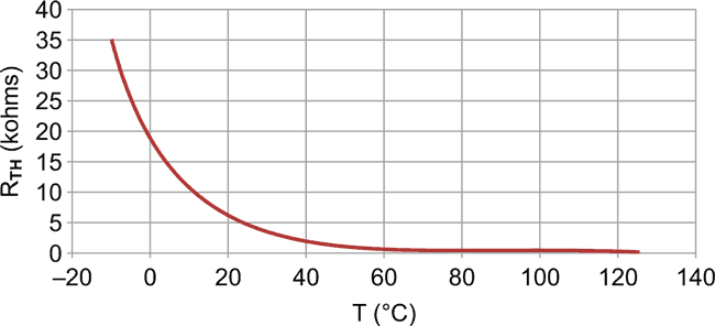

Figure 1 shows the temperature versus resistance plot for a Panasonic ERTJZET472 NTC thermistor. This graph shows that, on a linear scale, the resistance vs. temperature relationship is very nonlinear!
Getting a handle on thermistor temperature measurement
Figure 1. Resistance vs. Temperature for a Panasonic NTC thermistor.
Typically, the thermistors are rated by a parameter known as the R25 value. This is the typical resistance of the thermistor at 25 Celsius. The R25 value for this thermistor is 4700 ohms.

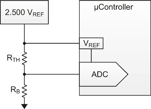

To a first-order approximation, we can see that the thermistor resistance versus temperature characteristic is roughly inversely proportional. That is the resistance is roughly inversely proportional with respect to temperature in a narrow range. Given this, we can create an inverse proportion circuit to try to linearize the resistance vs. temperature curve. Figure 2 shows how this is done.
Figure 2. An NTC thermistor linearizing circuit.
If we really wanted to save money, we could eliminate the voltage reference. Doing this will require some extra filtration to reject any power supply noise. It is important that the ADC reference and the thermistor sensor circuit reference are the same. Doing this allows us to use a ratiometric measurement method for the thermistor versus the ADC reading: That is, the measurement will be independent of the excitation voltage of the thermistor interface circuit.
The temperature reading is dependent only on the bias resistor, (RB) and the thermistor resistance, (RTH). We can call this ratio the divider ratio (D). The equation for the divider ratio is the simple voltage divider equation as shown in Equation 2.
Equation 2. Thermistor linearization divider ratio.

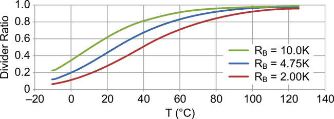

Figure 3 shows a set of curves for the various bias resistor values for the thermistor linearizing circuit. This figure also shows a reasonable degree of linearity within the 0 to 70 Celsius range, with the best linearity being achieved using a lower value of the bias resistor.

Figure 3. A plot of the divider ratio vs T for various bias resistor values.

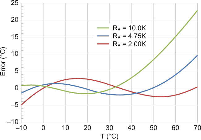

Another, better way to look at this would be to plot the difference between the datasheet values for temperature and the linearized values. This plot is shown in Figure 4. This figure also shows the best linearity is achieved with the lower bias resistor value. This figure shows that a 2.00 Kohm bias resistor will yield a linearity of about ±3 degree Celsius over the 0 to 70 degree temperature range.

Figure 4. Relative errors for various bias resistor values.
In this example, the linear equation for the temperature versus resistance ratio, for a 2 Kohm bias resistor is given in Equation 3.
Equation 3. Temperature versus resistance
