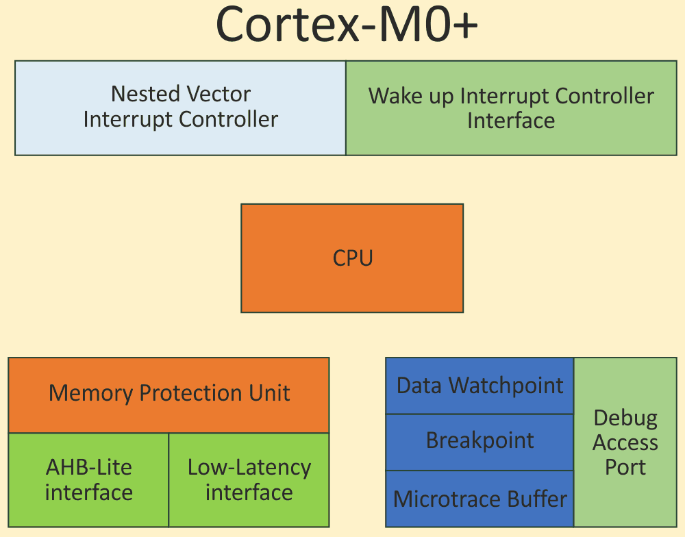

So, what’s important to know about Cortex-M0+ (see Figure 1)? The Cortex-M processor series as a whole is supposed to fill a market need for devices with limited power consumption and are low cost, and thus are suitable for a broad range of applications. The Cortex-M0+ processor takes the family further by offering the smallest footprint and lowest power requirements. This extra step makes Cortext-M0+ a good fit for wearables and sensors.
| Figure 1. | The 32-bit Cortex-M0+ is a small footprint microprocessor. |
Cortex-M0+ has been optimized for specific needs, and it includes complete instruction set compatibility with the Cortex-M0. That means identical compiler and debug tools can be used across both.
Cortex-M0+ has a silicon option called Micro Trace Buffer (MTB) that delivers a simple instruction trace buffer. This is in addition to debug capabilities in the Cortex-M0. Cortex-M3 and -M4 features can also be added as silicon.
The key things to know about Cortex-M0+ is that it’s based on ARMv6-M architecture and shares instruction sets with Cortex-M0. The applicable sub-instruction sets are Thumb-1 (most); missing CBZ, CBNZ, IT, and Thumb-2 (some); and only BL, DMB, DSB, ISB, MRS, MSR.
Cortex-M0+ has 32-bit hardware integer multiply with 32-bit results, 1 to 32 interrupts, plus NMI.
The function of the Cortex-M0+ Memory Protection Unit (MPU) is to oversee the CPU's use of memory and make sure no task corrupts the memory or impacts other active tasks. Typically controlled with an RTOS, the MPU can detect attempted memory access that’s not authorized.
