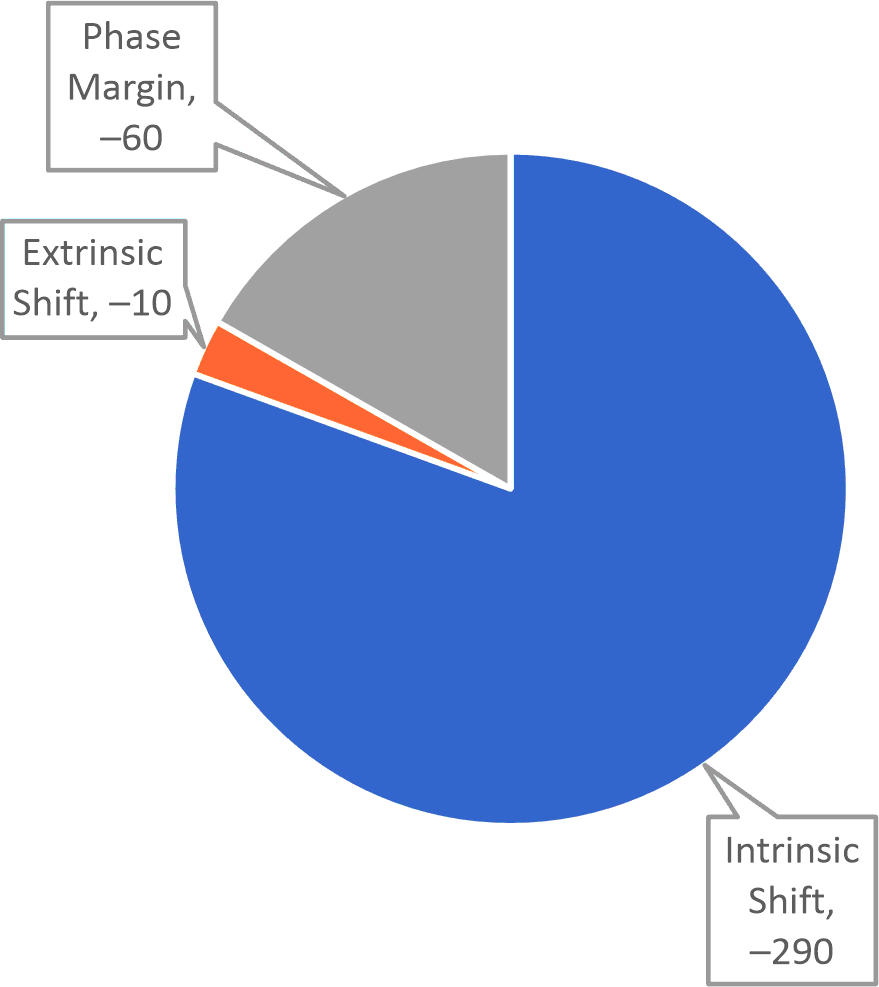

It’s possible to visualize the phase shift of the feedback loop with a pie chart, since 360 degrees of phase shift corresponds well to 360 degrees of a circle (Figure 1).
Each source of phase lag will take up more and more of the pie. Once you have reached 360 degrees of shift, you have consumed your whole phase margin pie, and the circuit is unstable. Phase lag is expressed as a negative phase shift, and phase lead is expressed as a positive phase shift.
| Figure 1. | Pie chart of amplifier-loop phase shift is shown with numbers noted as degrees of phase margin. |

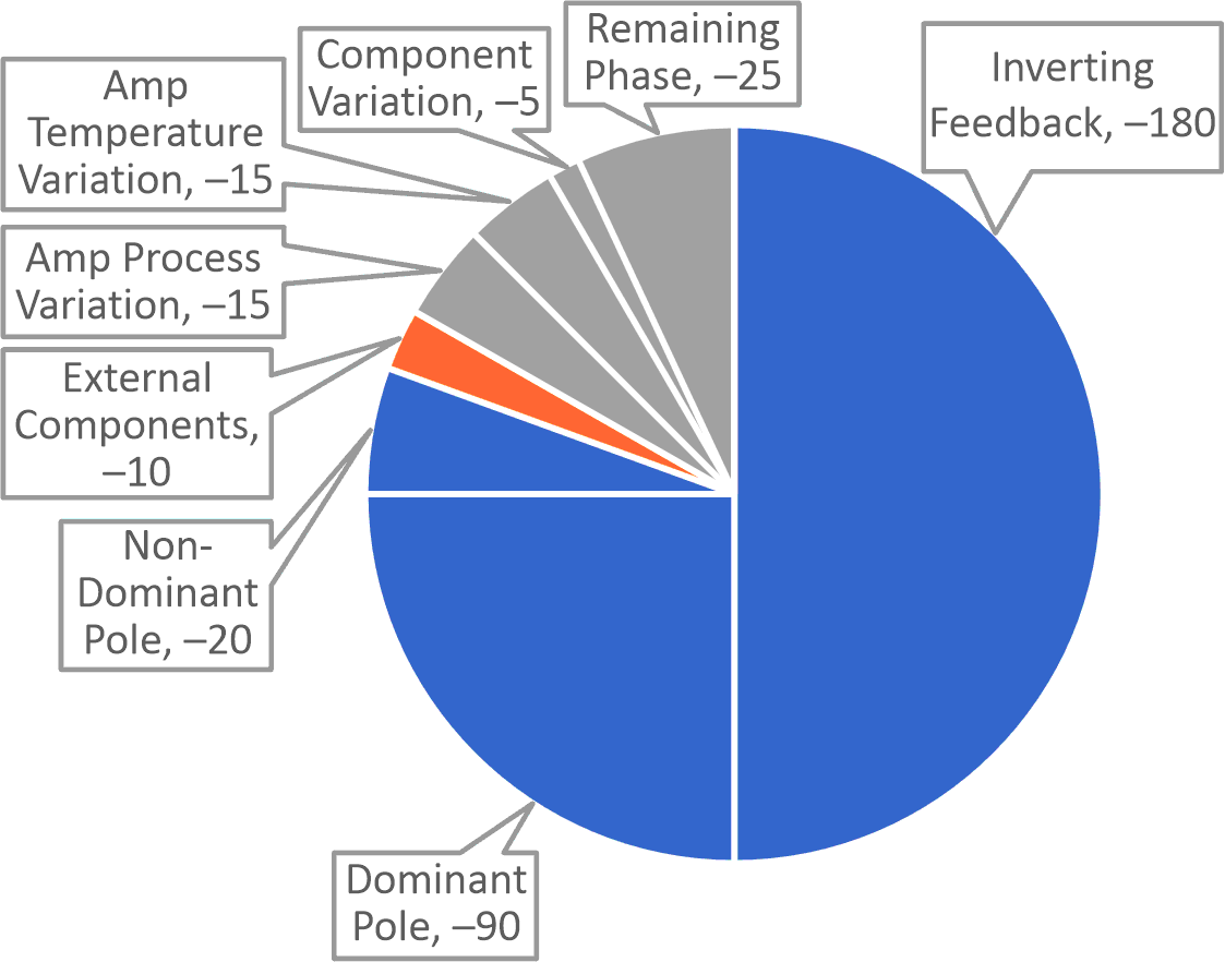

Looking at Figure 2, if the total shift is –180 degrees for inverting feedback, –90 degrees for the dominant AOL pole, –20 degrees for the nondominant AOL pole and –10 degrees from external components, then there is –60 degrees of phase shift before the amplifier reaches –360 degrees of phase shift and is in positive feedback.
| Figure 2. | Here is an expanded pie chart of amplifier loop phase shift. |

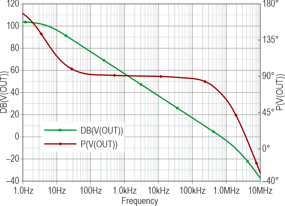

Although Miller compensation reduces the need to create very large capacitors in silicon, it results in a large amount of variance in the AOL when the Miller capacitor varies over process and temperature. Looking at Figure 3, the worst case for stability will be a combination of two factors: an increase in AOL coupled with a smaller Miller capacitor results in a larger unity gain bandwidth.
| Figure 3. | The above bode plot represents a typical operational amplifier. |
This means that the phase lag introduced by the nondominant poles at high frequency will more severely degrade the phase of the feedback loop.
The rule of thumb for bandwidth variation in operational amplifiers is 30% variation across process, and an additional 30% across temperature. The biasing structures set the open-loop output impedance, which can see variation over process; thus, a good approximation is about 15%. It’s because of the variance in these factors, as well as some other parametric shifts in the amplifier over process, that drive the recommendation for 45 degrees of phase margin.
