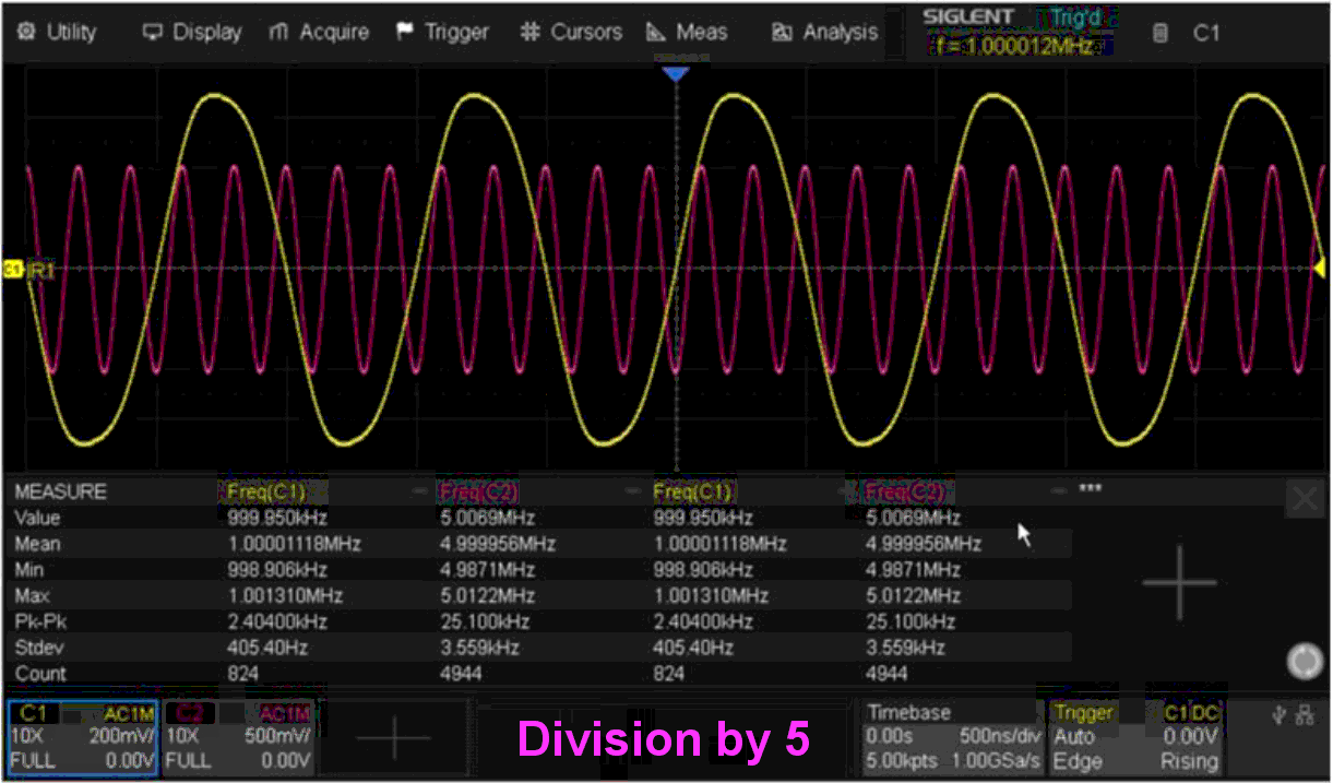

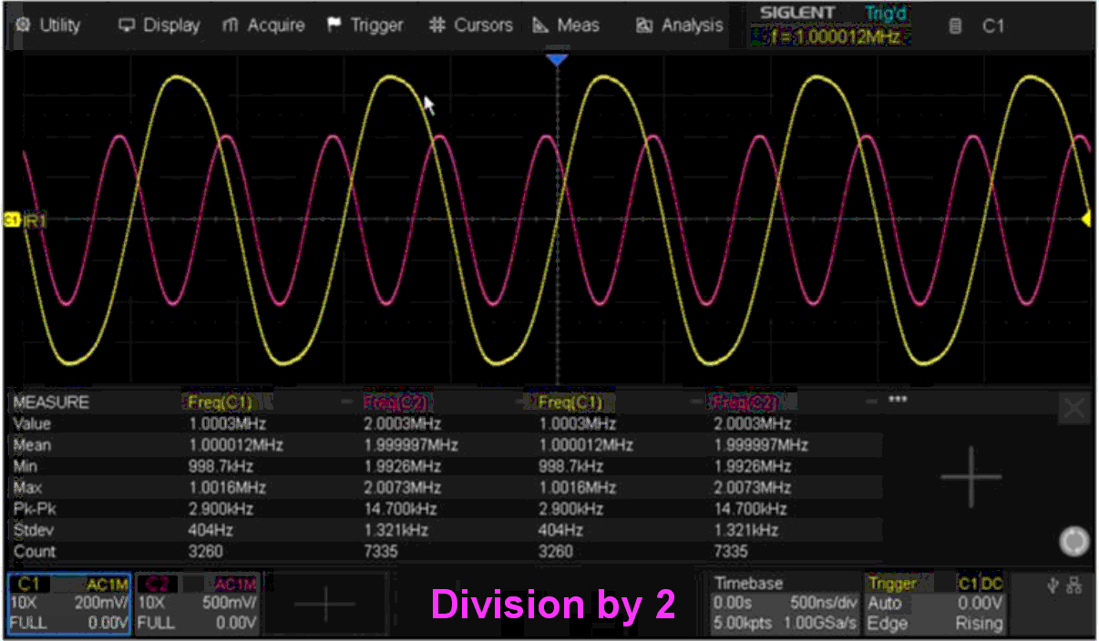

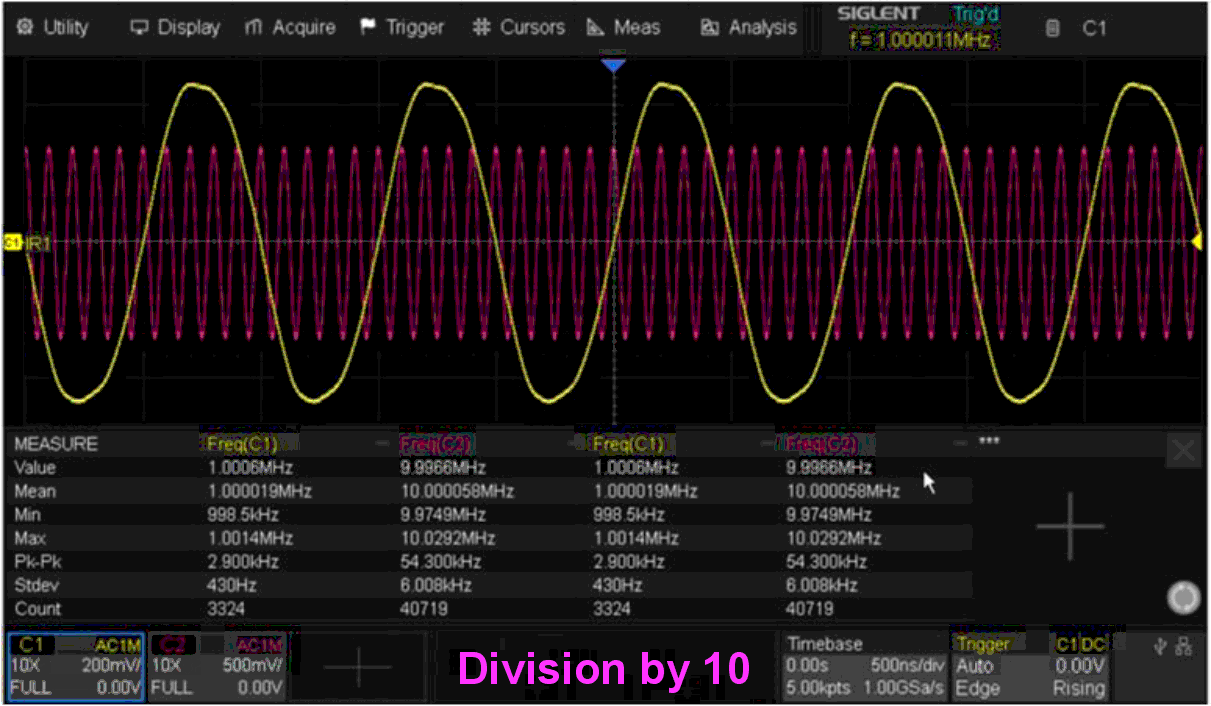

Signal injection is by means of a series 10 kΩ and 0.01 µF RC connected to the common emitters of the Q1 and Q2 2N3906 transistors. The subtle non-linearities within the oscillator allow selective frequency locking and division without additional active components. Figure 2 shows examples of frequency division by 2, 3, 5, and 10 respectively without any component values or circuit changes!
Examples of frequency division by 2, 3, 5, and 10 without any changes to the component values or circuit, this is due to the subtle non-linearities within the oscillator that allow selective frequency locking and division.
Figure 2. Examples of frequency division by 2, 3, 5, and 10 without any changes to the component

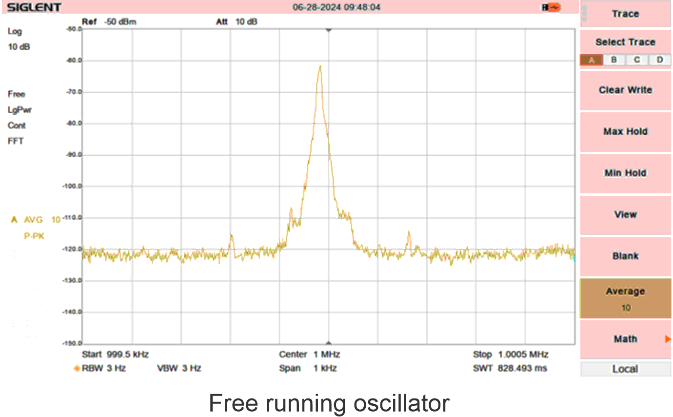

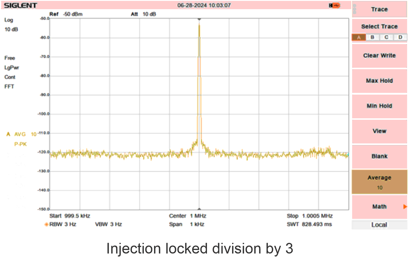

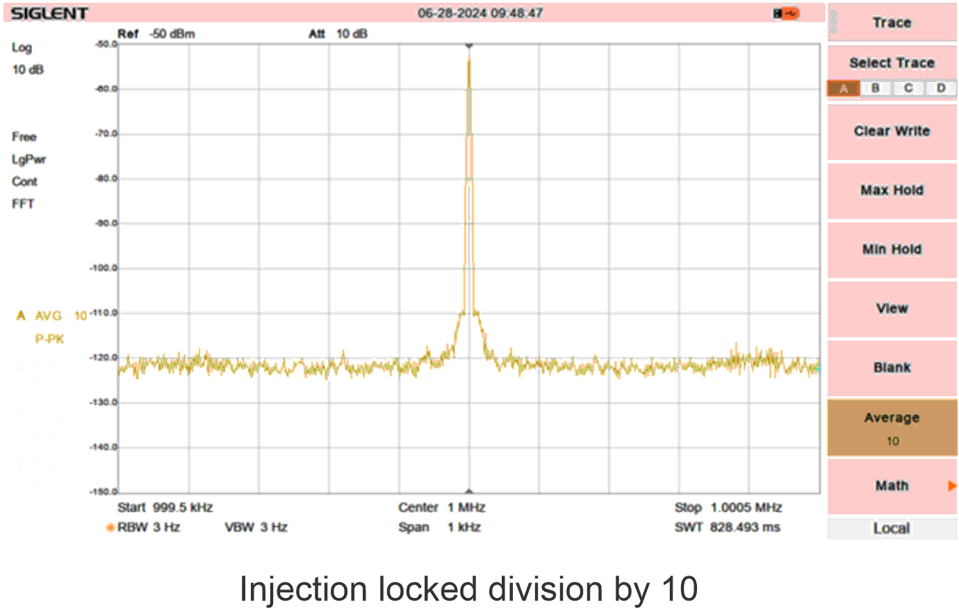

Injection locking also improves the oscillator phase noise even when acting as a divider. Figure 3 shows some results from the free running oscillator and when acting as a frequency-selective divider.
Spectrum analysis of the oscillator free running and when acting as a frequency-selective divider with an injection-locked division of 3 and 10. There is a marked improvement in phase noise when acting as a frequency-selective divider.
Figure 3. Spectrum analysis of the oscillator free running and when acting as a frequency-selective
The test setup used a general-purpose AWG (SDG2042X) as the signal source, a DSO (SDS814X HD) and spectrum analyzer (SSA3021X Plus) for the displays. Of course this technique isn’t going to replace a proper digital divider, but might find use in a pinch when one needs frequency division, or improve a simple oscillators stability and phase noise.
