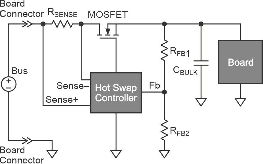

Here is how a generic hot swap implementation looks like (Figure 2).
Here is a closer look at an arrangement built around a hot swap controller.
Figure 2. Here is a closer look at an arrangement built around a hot swap controller.
When the board is connected to the bus, the capacitor CBULK will charge with a large inrush current if the hot swap controller is not present. With the hot swap controller in place, the inrush current is sensed via voltage drop across the current sense resistor RSENSE, and it is then used to limit the current. The feedback Fb pin is used to monitor the output voltage for under- and over-voltage conditions. A critical component in this setup is the power MOSFET.

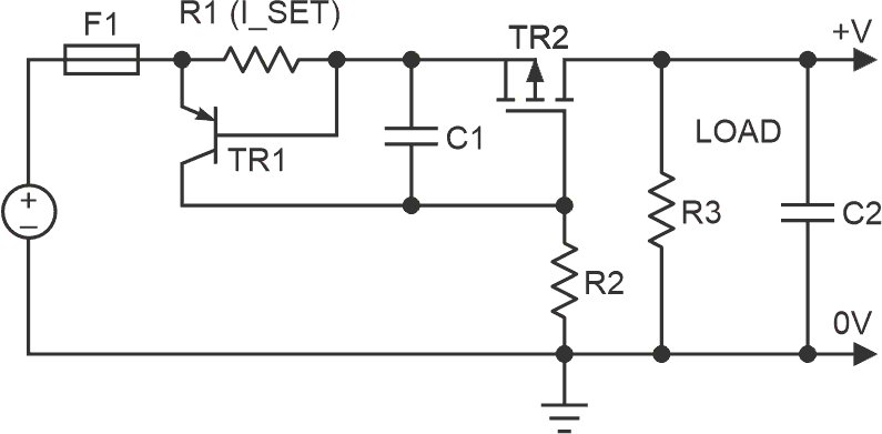

This circuit idea for hot swap applications uses a regular PNP transistor (TR1) and a current sense/set resistor (R1) to provide continuous current sensing and limiting (Figure 3). As power is applied, current flows through R1 and TR2 to the LOAD. Current through R1 creates the VBE bias voltage for TR1. If the current is large enough to bias TR1 on, then TR1 limits conduction through TR2 to the LOAD by scaling down the gate-source voltage of TR2.
Here is how a typical discrete hot swap topology looks like.
Figure 3. Here is how a typical discrete hot swap topology looks like.

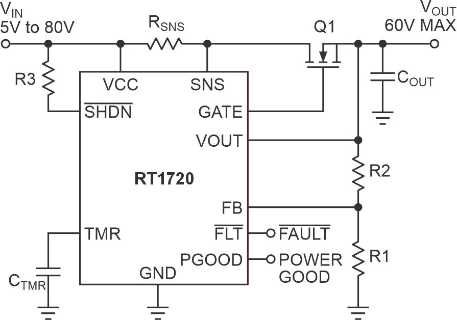

Notably an IC-based hot swap scheme offers many features in a small package and the IC necessitates only a few external components. Figure 4, for example, depicts the simplified application circuit of the RT1720 hot swap controller with fault timer.
The application is built around the RT1720 hot swap controller.
Figure 4. The application is built around the RT1720 hot swap controller.

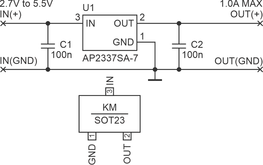

For some quick experiments related to this post, I randomly selected the AP2337 hot swap controller IC.
The AP2337 is a single-channel current-limited integrated high-side power switch optimized for hot swap applications. The device, available in SOT23 package, offers reverse current blocking, over-current, over-temperature and short-circuit protection, as well as controlled rise time and under-voltage lockout functionality.
The AP2337 application circuit is shown in Figure 5.
AP2337 offers a fast short-circuit response time to improve overall system robustness.
Figure 5. AP2337 offers a fast short-circuit response time to improve
Since this was just a quick experiment and I was driving a simple test load, I deliberately took some temporary shortcuts. When I do something more with this concept, I will solder everything to a perf board or a custom PCB to make it more robust.
