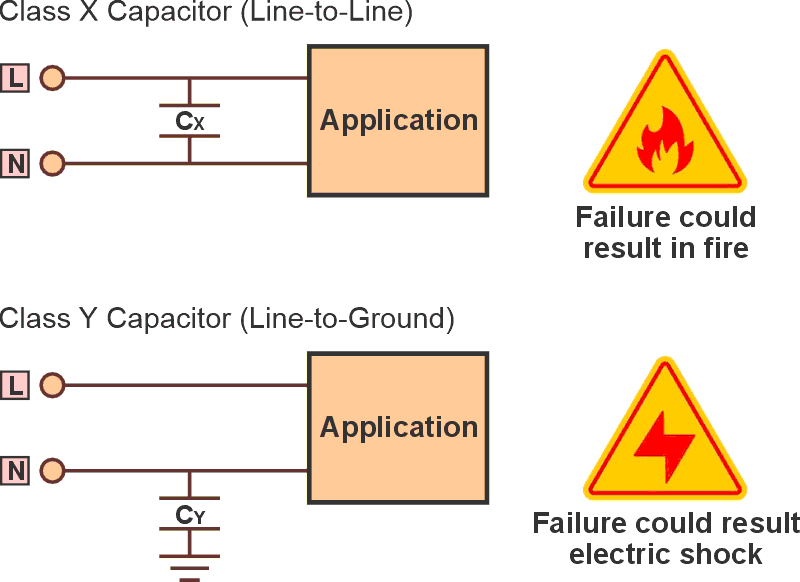

The X-capacitors are used for differential-mode EMI filtering, while Y-capacitors are used for common-mode EMI filtering by bypassing the interference from the wires to ground (Figure 1).
The proper placement of the X- and Y-capacitors with respect to the AC line is well-defined and unambiguous.
Figure 1. The proper placement of the X- and Y-capacitors with respect to the AC line
Class-X capacitors are used to minimize EMI/RFI that may be caused by differential mode noise in an AC power supply and are often referred to as “line to line” or “across the line” capacitors. They are placed across the AC “line” (black) and AC “neutral” (white) connections to minimize negative effects due to conducted interference, overvoltage surges, and voltage transients.
Remember that a proper single-phase AC line has three connections: line, also called “hot”; neutral; and ground.
Not just any capacitor of the right value is suitable for either X or Y roles. Class-X capacitors endure all the AC line variations and stress in their role of providing a clean AC signal to the circuit, which is their load. This can create a hazardous situation
if the voltage or power threshold of the capacitor is exceeded. Due to the risks of this over-stress situation, Class-X capacitors are designed to short-circuit when they fail, which will trigger the circuit breaker or fuse to break the supply circuit.
In contrast, class-Y capacitors are often referred to as “line to ground” or “line bypass” capacitors. Class-Y capacitors are placed in between the AC supply and ground to handle EMI/RF noise caused by common-mode noise on the AC line.

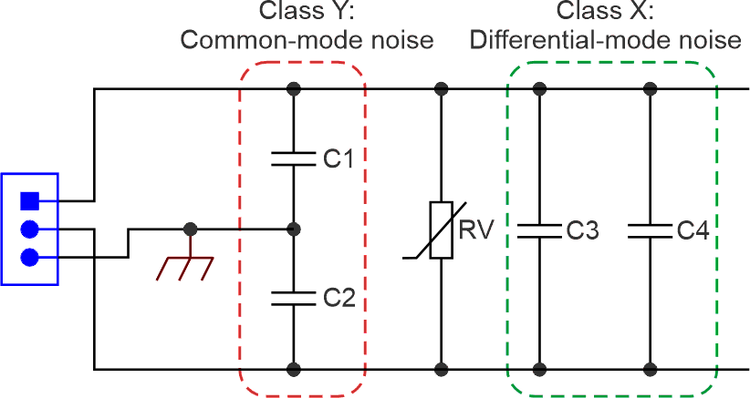

Their failure-mode situation is not the same as it is for Class-X capacitors. Class-Y capacitors are designed to fail open-circuit, as shorting of a Y-capacitor could present a fatal shock hazard for personnel using the equipment. While failing as an open circuit exposes the load circuit to an unfiltered AC power source, the risk of fire is reduced. Note that the failure mode designed into Class-X capacitors is the opposite of the mode for Class-Y capacitors. Both Class-X and Class-Y capacitors are needed in a typical AC power application (Figure 2).
This schematic shows how to use both capacitors in an AC-line input circuit.
Figure 2. This schematic shows how to use both capacitors in an AC-line input circuit.
Representative capacitance values for these capacitors are a function of the application specifics, current voltage and current levels, and other factors. They typically range from as low as 20 picofarads (pF) to 1,000 pF but can be larger.
