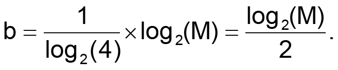

If you want to solve for b given M: b = log4(M)
Or,
You may be scratching your head, wondering where that formula comes from. First, let’s think about the readings we are averaging. They consist of two parts. The first is the true, clean reading the sensor is trying to give us. The second part is the noise that we pick up from extraneous signals on the wiring, power supplies, components, etc. (These two signal parts combine in an additive way.)
We will assume that this noise is Gaussian (statistically normally distributed; often shown as a bell curve; sometimes referred to as white noise) and uncorrelated to our sample rate. Now, when taking the average, we first sum up the readings. The clean readings from the sensor will obviously sum up in a typical mathematical way. In the noise part, though, the standard deviation of the sum is the square root of the sum of the standard deviations. In other words, the clean part increases linearly, and the noise part increases as the square root of the number of readings.
What this means is that not only is the resolution increased, but the signal-to-noise ratio (SNR) would improve by M/sqrt(M), which mathematically reduces to sqrt(M). In simpler terms, the averaged reading SNR improves by the square root of the number of samples averaged. So, if we take four readings, the average SNR improves by 2, or the equivalent of one more bit in the ADC (an 8-bit ADC performs as a 9-bit ADC).

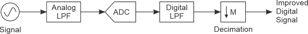

So, let’s look at a design to create a more advanced oversampling system. Figure 1 shows a typical layout for a more “formal”, and better oversampling design.
A typical oversampling block diagram with an antialiasing filter, ADC, digital LPF, and decimation (down-sampling).
Figure 1. A typical oversampling block diagram with an antialiasing filter, ADC, digital LPF, and decimation (down-sampling).
We start by filtering the incoming signal with an analog hardware LPF (often referred to as an antialiasing filter). This filter is typically designed to filter the incoming desired signal at just above the frequency of interest.
Note: not shown, but a good design feature, is a flywheel circuit close to the ADC input. The capacitor in this RC circuit provides a charge to hold up the voltage level when the ADC samples the input. More on this can be found at: " ADC Driver Reference Design Optimizing THD, Noise, and SNR for High Dynamic Range Instrumentation" (Ref. 2).
The ADC then samples the signal at a rate many times (M) the frequency of interest’s Nyquist rate. Then, in the system’s firmware, the incoming sample stream is again low-pass filtered with a digital filter (typically an FIR or IIR) to further remove the signal’s Gaussian noise as well as the quantization noise created during the ADC operation. (Various filter designs can also be useful for other kinds of noise, such as impulse noise, burst noise, etc.) Oversampling gave us the benefit of spreading the noise over the wide oversample bandwidth, and our digital lowpass filter can remove much of this.
Next, we decimate the signal’s data stream. Decimation (also known as down-sampling) is simply the act of now only using every 2nd, or 3rd, or 4th, up to every Mth sample, and tossing the rest. This is safe due to oversampling and the lowpass filters, so we won’t alias much noise into the lower sample rate signal. Decimation essentially reduces the bandwidth as represented by the remaining samples. Further processing now requires less processing power as the number of samples is significantly reduced.
