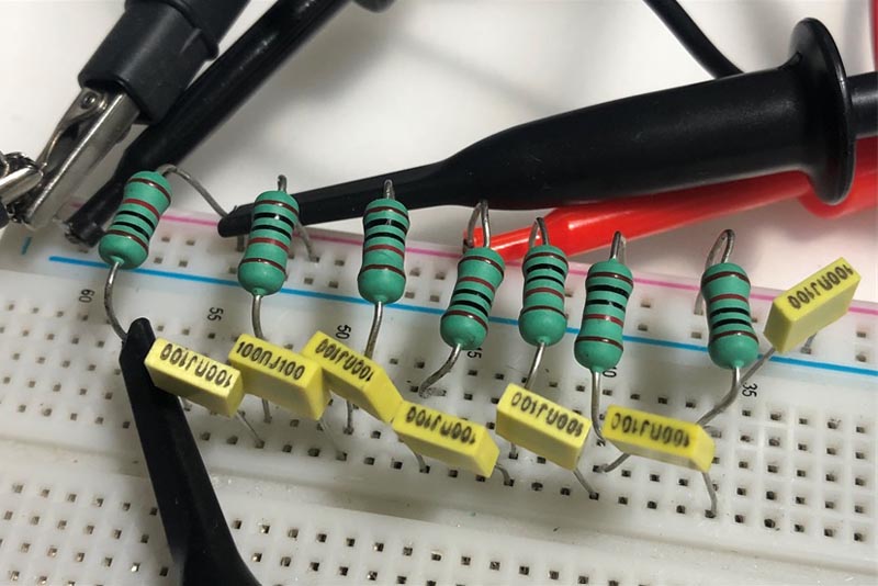

I built one with seven sections (Figure 2) using an R of 10 kΩ and a C of 0.1 µF, then plotted the results.
A seven-section RC ladder network with an R of 10 kΩ and C of 0.1 µF.
Figure 2. A seven-section RC ladder network with an R of 10 kΩ and C of 0.1 µF.

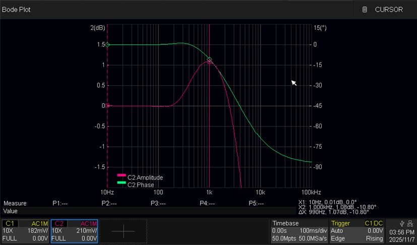

The Bode plot can be seen in Figure 3. As you can see, the gain remains around 0 dBv and behaves as a low-pass filter, then slowly rises to a peak of 1.07 dBv at 1 kHz before falling off.
Bode plot of the passive RC circuit showing low-pass filter behavior until a slow rise to a peak of 1.07 dBv at 1 kHz.
Figure 3. Bode plot of the passive RC circuit showing low-pass filter behavior until a slow
rise to a peak of 1.07 dBv at 1 kHz.an R of 10 kΩ and C of 0.1 µF.

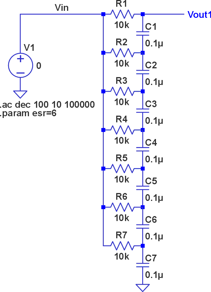

This agrees well with the simulation shown in Figure 4.
Circuit simulation of a passive RC circuit that closely matches the Bode plot shown in Figure 3.
Figure 4. Circuit simulation of a passive RC circuit that closely matches

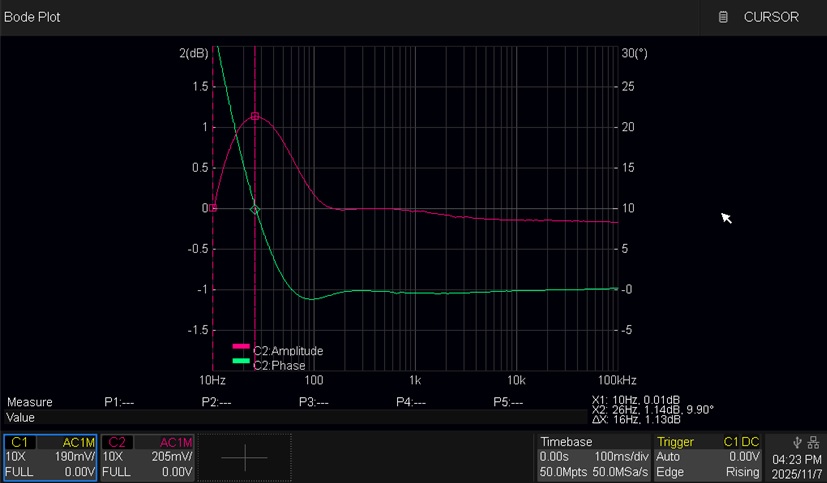

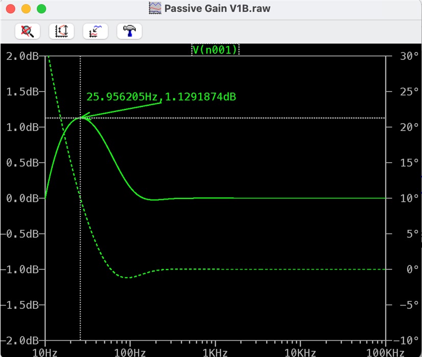

If you swap the resistors and capacitors, the circuit behaves like a high-pass filter and produces a higher gain of 1.13 dBv at 26 Hz, as shown in Figure 5, and a simulation in Figure 6.
Bode plot of the passive RC circuit showing high-pass filter behavior.
Figure 5. Bode plot of the passive RC circuit showing high-pass filter behavior.
Circuit simulation of a passive RC circuit that closely matches the Bode plot shown in Figure 5.
Figure 6. Circuit simulation of a passive RC circuit that closely matches
