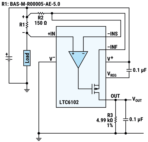

The circuit shown in Figure 1 uses the LTC6102 and an Isabellenhütte* 50 μΩ current shunt. The current in the load develops a voltage across sense resistor R1. This device has a feedback loop that keeps +IN and –INS at the same voltage by sinking current into the –INF pin. Therefore, the voltage across R1 is the same as the voltage across R2. Thus, the current through R2 is lower than the load current by the ratio of R2 to R1. This current flows through the OUT pin and develops a voltage across R3 that can then be measured.
Схема измерения тока.
Figure 1. The current sense circuit.
The output voltage is represented by Equation 1.
  (1)
Likewise, with Equation 2.
  (2)

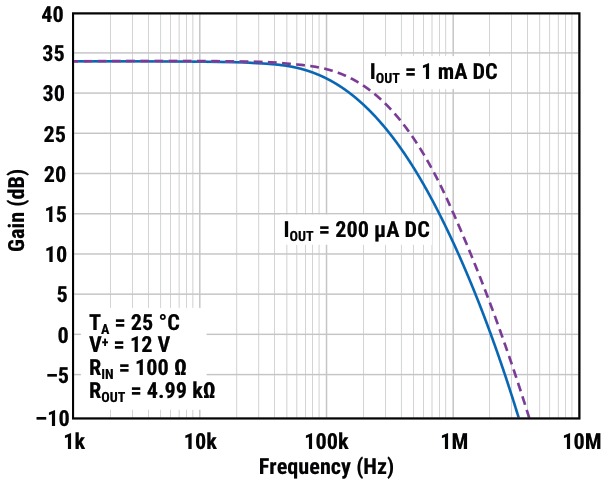

The LTC6102 is good for measuring DC to a high level of precision, but what about its ability to measure AC? A buck converter’s input current has a large AC content, and if its efficiency is to be determined, the IC must measure this current with a high degree of precision.
Figure 3 shows the frequency response.
The gain vs. frequency of the LTC6102.
Figure 3. The gain vs. frequency of the LTC6102.
Many DC-to-DC converters switch at a frequency between 200 kHz and 500 kHz, and Figure 3 shows that the attenuation is not significant at these frequencies, so the output of the part will show ripple when measuring the input current of a buck converter. However, this attenuation can be greatly increased by adding a capacitor across output resistor R3, as shown in Figure 1.

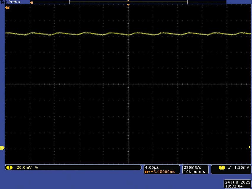

An RC filter consisting of a 47 Ω resistor and a 10 μF capacitor was placed across the sense resistors and the voltage across the filter capacitor was measured, as shown in Figure 5. This enabled the input current to be measured more accurately with a multimeter, but without changing the value of the shunt resistor.
The filtered voltage across the sense resistor.
Figure 5. The filtered voltage across the sense resistor.
The voltage across the 10 μF capacitor was measured as 143.6 mV, which corresponds to an input current of 1.005 A.

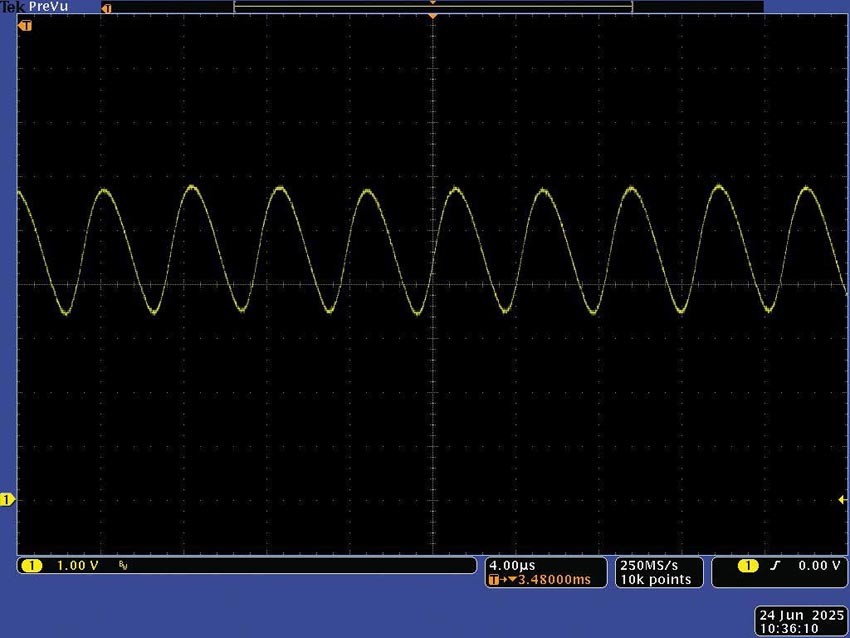

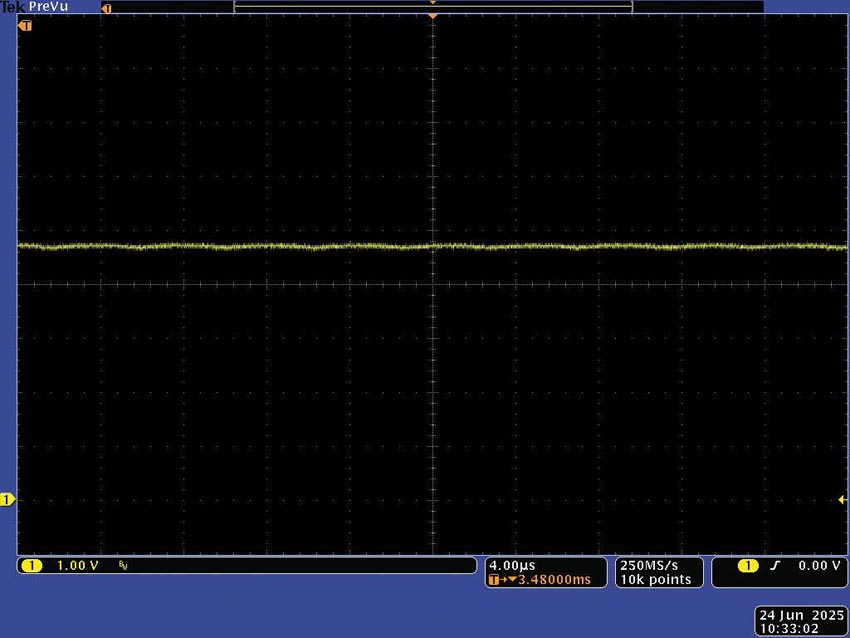

Then the output voltage of the LTC6102 was measured. Figure 6 shows the output voltage without the 0.1 μF capacitor across R3.
The unfiltered output voltage.
Figure 6. The unfiltered output voltage.
Adding a 0.1 μF capacitor across R3 enabled the output voltage to be measured more accurately, as shown in Figure 7.
The output voltage with 100 nF across R3.
Figure 7. The output voltage with 100 nF across R3.
The output voltage across R3 was measured at 4.75 V using a multimeter. This equates to a shunt voltage of 142.79 mV and hence a shunt current of 0.999 A, which is close to the previously measured current of 1.005 A. It is interesting to note that the percentage difference between these two currents is –0.57%, similar to the error shown in the Table 1.

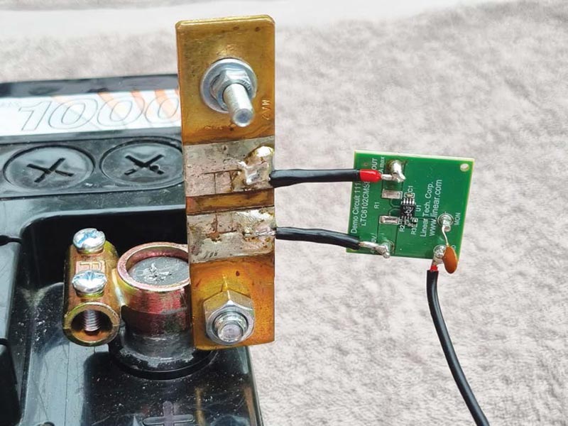

Figure 8 shows the shunt circuit connected to a car battery. A hot air gun was used to solder the wires to the shunt.
The complete current sense circuit.
Figure 8. The complete current sense circuit.

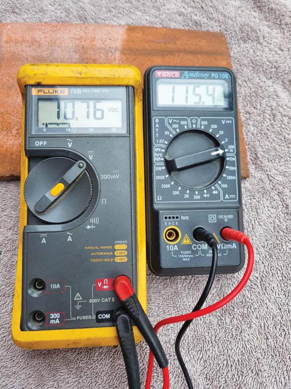

Voltmeters were connected across the load and the output of the LTC6102 as shown in Figure 9. An output voltage of 115.4 mV corresponds to a load current of 69.38 A.
The calculated load current for a 10.76 V battery is 68.68 A, so the device is measuring the current to an accuracy of 1%.
