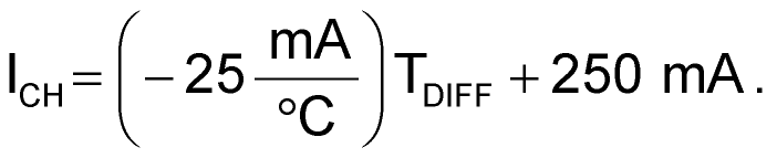

Consider an example design that must convert a differential temperature ranging from 0 °C to 10 °C into a charging current that decreases proportionally from C/3 to 0 A. If C equals 750 mA, C/3 equals 250 mA and the equation to describe this linear system is:

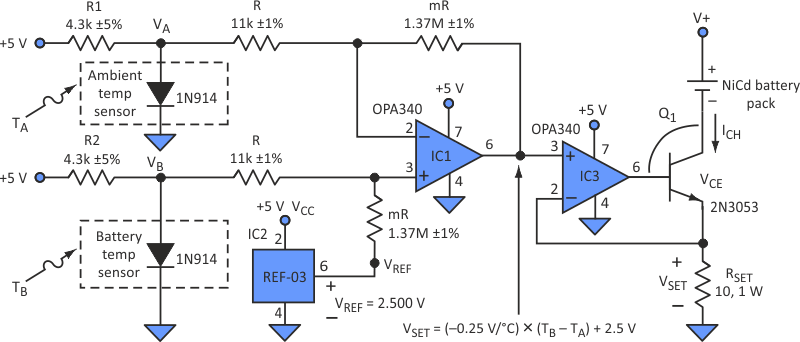

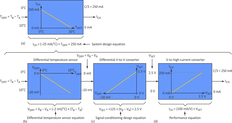

Figure 1 represents this design equation (Fig. 1a), including graphical and mathematical descriptions of the main circuit elements: temperature sensor circuitry (Fig. 1b), a differential-voltage-to-voltage converter (Fig. 1c), and a voltage-to-high-current converter (Fig. 1d). The circuit measures the two relevant temperatures, TB and TA, individually using two matched low-cost silicon-diode temperature sensors.
The sensor outputs, VB and VA, are applied to the inputs of a differential amplifier that subtracts, scales, and offsets these voltages, producing a single-ended control voltage (VSET) that’s inversely proportional to TDIFF. Finally, a voltage-to-high-current converter delivers the needed charging current (ICH), which is directly proportional to VSET.
Figure 1 shows that at a TDIFF of 0 °C (VDIFF = 0 V), VSET is chosen to be 2.5 V and will set the maximum charging current of 250 mA. When the TDIFF rises to 10 °C (VDIFF = –20 mV), VSET will have linearly dropped to 0 V, causing ICH to drop to 0 and charging to cease.
The design begins by writing three linear equations that describe each of the circuit elements depicted graphically. The two temperature-derived diode voltages (Fig. 2) are applied to the inputs of a standard difference amplifier (IC1), which subtracts sensor voltage VA = (–2 mV/°C)TA + 670 mV from VB = (–2 mV/°C)TB + 670 mV to produce a differential voltage (VDIFF):
(2) |
In addition to performing the subtraction described by Equation 2, IC1 amplifies VDIFF by a differential gain (ADIFF), determined to be 125, and adds an offset voltage of +2.5 V to the output. The differential amplifier’s performance equation is:
(3) |
The components are selected by simply comparing gain and offset terms to design the needed signal-conditioning circuit described by:
(4) |
Notice that comparing terms also shows how to correctly wire the inputs – i.e., VB must be wired to the V(+) input and VA must be wired to the V(–) input. IC1’s differential gain is:
(5) |
VREF is set by IC2, a low-output-impedance reference chip (a REF-03) that creates precisely 2.50 V.

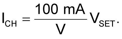

The design of the voltage-to-high-current converter starts by noting that ICH is directly proportional to the temperature-dependent voltage, VSET, and circuit performance is:
(6) |

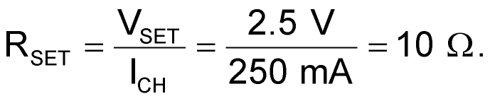

Finally, note that negative feedback around IC3 forces VSET to be applied directly across the current-setting resistor, RSET, making:
