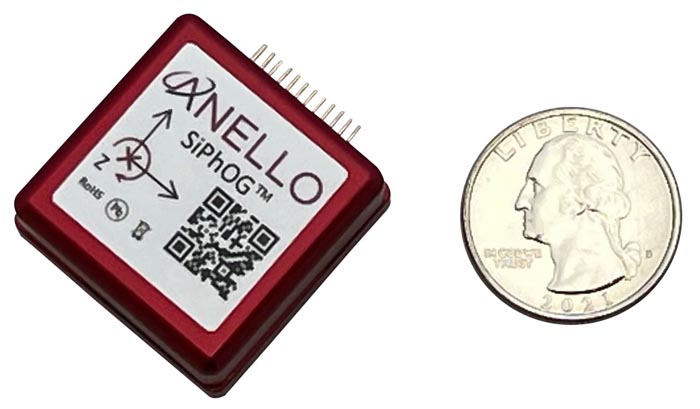

For example, ANELLO Photonics has developed a silicon photonics optical gyroscope – dubbed SiPhOG – that uses an on-chip waveguide manufacturing process, integrated with a patented silicon photonic integrated circuit (Figure 1). Together, they claim these offer fiber-optic gyro performance with a standard silicon manufacturing process.
This silicon photonics optical gyroscope uses an on-chip waveguide manufacturing process that is integrated with a patented silicon photonic IC.
Figure 1. This silicon photonics optical gyroscope uses an on-chip waveguide manufacturing

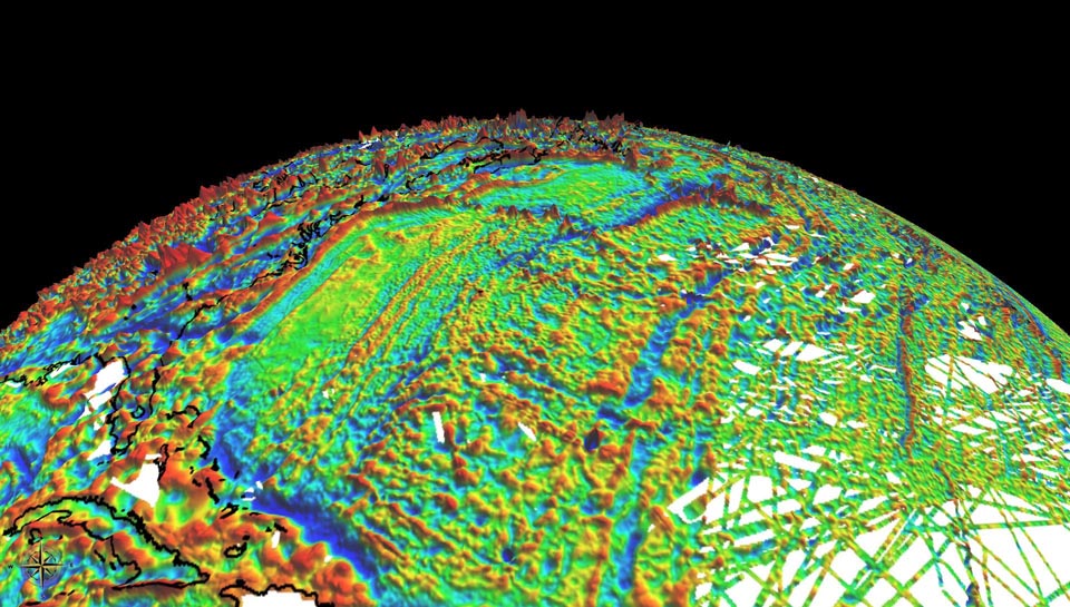

The Earth’s magnetic field is pervasive, ubiquitous, and unjammable. It’s also uneven, with highly localized variations due to differences in the Earth’s outer-crust and under-crust layers as well as deeper causes (literally) from flows of conducting material within the Earth (Figure 2).
This geomagnetic map of part of the Northern hemisphere is a starting point for more detailed, higher-resolution images and variations, and changes that must be captured for effective magnetic navigation.
Figure 2. This geomagnetic map of part of the Northern hemisphere is a starting point for more detailed, higher-
Using supersensitive quantum-based magnetic sensors based on optically pumped, cesium-based, split-beam scalar magnetometers, which have an absolute accuracy between one and three nanoteslas, it’s possible to read that field with high precision. The Earth’s core field has values ranging from 25 to 65 microtesla (that’s 0.25 to 0.65 gauss) at the surface while magnetic anomaly field of interest typically varies by just hundreds of nanotesla.
The readings are then matched to pre-existing maps of Earth’s field. This scheme has the disadvantage of not being very accurate compared to GPS, partially because the Earth’s magnetic field is not static and matching maps need constant updating.
Despite these challenges, companies such as SandboxAQ have developed a navigation technology (AQNav) that leverages proprietary large quantitative models (LQMs) and powerful quantum sensors to make use of the Earth’s crustal magnetic field. By combining high-sensitivity magnetometers with AI algorithms to identify unique magnetic patterns and locate position in real time, it’s possible to determine position in that field. The sensing is entirely passive, so users remain undetected.

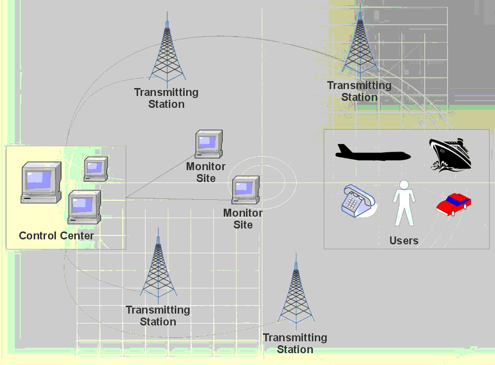

Enhanced LORAN is a standard which builds on the now obsolete LORAN system by putting more information into the modulation of the carrier as well as adding a data channel. Like LORAN, E-LORAN offers some benefits such as near-impossibility of jamming and spoofing, but it also requires many high-power transmitters and many of these need to be in inhospitable or remote locations which are difficult to support (Figure 3).
Like its predecessor LORAN, the enhanced LORAN system will require an extensive physical infrastructure located around the world.
Figure 3. Like its predecessor LORAN, the enhanced LORAN system will require an extensive
While E-LORAN proponents are eternally hopeful, the project has had difficulty getting traction and support due to technical challenges (primarily at the transmitter side), very high up-front infrastructure costs, and best-case accuracy of about 50 to 100 meters (although there are proposed ways to improve that number).
