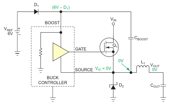

Many buck-controller ICs use a floating-gate driver

Buck regulator handles light loads
Figure 1. Many buck-controller ICs use a floating-gate driver
Figure 2. During CCM, current always flows through the inductor. Q1 or D2 supplies this current during the flyback event that Q1's turn-off causes
