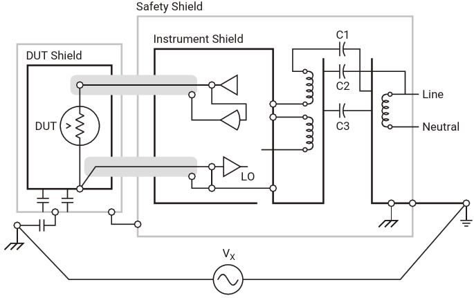

An illustration of the power system components that generate common mode current, as well as the isolation capacitances that support AC currents generated externally
AuthorsSafety Grounding
Main DocumentArticle «Understanding grounding, shielding, and guarding in high-impedance applications. Part 2»
DescriptionFigure 4
File Format / SizePDF / 40 Kb
