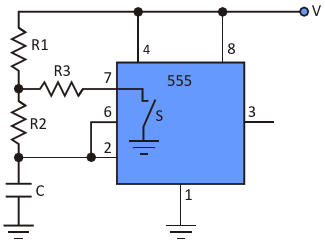

Adding R3 to a standard 555 timer circuit allows a designer to create a 50% duty cycle

Adjust 555-Based Generator's Duty Cycle without Affecting Frequency
Figure 1. Adding R3 to a standard 555 timer circuit allows a designer to create a 50% duty cycle
Figure 2. The third resistor doesn't affect the circuit's normal charge-discharge cycle
