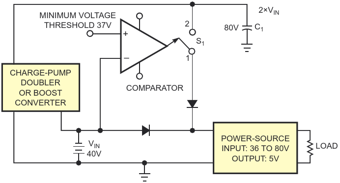

Charged to double the input voltage, the energy stored in capacitor C
1
dumps into the input of the "brick" power supply during brownouts when the input voltage drops to less than -37 V
