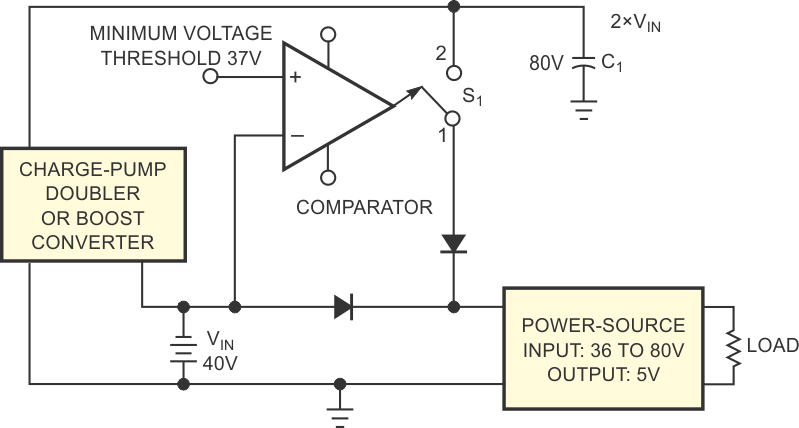

This Design Idea still requires a capacitor, but the capacitor has a lower value – that is, 200 µF versus 4500 µF – and sustains 100 W during a 5-msec brownout. This approach increases reliability and reduces cost and size. The hidden feature is the power brick’s ability to stay operational over the input range of –36 to –75 V and even to operate under surges greater than –80 V. Figure 1 shows how you can use this feature. The figure depicts a positive input voltage. The brick is isolated, so polarity is irrelevant, but positive interpretation is easier to illustrate.
Small capacitor supports telecom power supply during brownouts
Figure 1. Charged to double the input voltage, the energy stored in capacitor C1 dumps into the input of
the “brick” power supply during brownouts when the input voltage drops to less than –37 V.
Remember that the stored energy in the capacitor grows exponentially, whereas the capacitor’s voltage increases linearly. The doubler charges C1 to twice the input voltage or at least to 80 V. Even if, hypothetically, you expect a 5-msec brownout as often as 10 sec, the current to charge 200 µF is still only approximately 3 mA. The comparator watches the input voltage, and, as soon as it drops below 37 V, switch S1 closes, and the energy from C1 discharges to the power brick.
