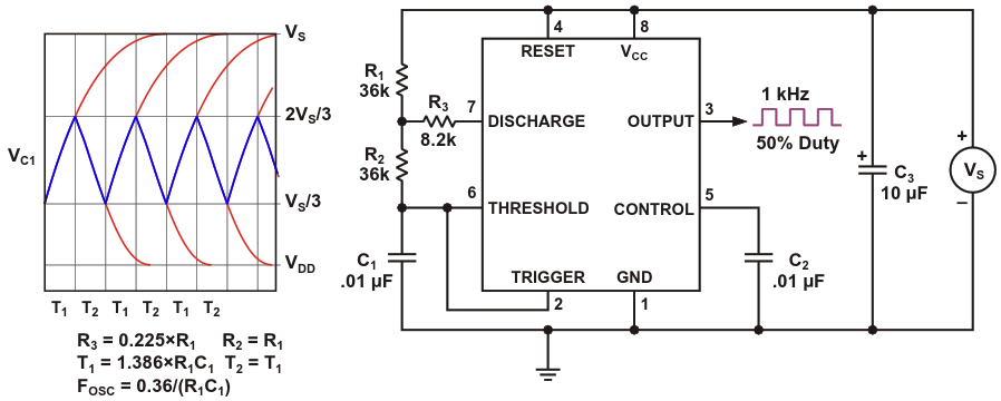

Add One Resistor to Give Bipolar LM555 Oscillator a 50:50 Duty Cycle
Figure 2
18 Kb
Figure 1. «Traditional two-resistor» 555 oscillator
Figure 2. New «three resistor» topology
