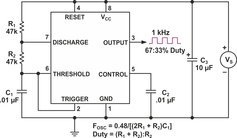

«Traditional two-resistor» 555 oscillator.
Figure 1. «Traditional two-resistor» 555 oscillator.
The origin of this myth seems to be early 555 datasheet application notes that illustrated the topology shown in Figure 1 for astable oscillation. Its expression for output duty cycle, D, which is
tells us 50:50 will be impossible unless R1 = 0. Since a short circuit from DISCHARGE to VS would seem more likely to make the part output smoke than square waves, the conclusion follows: 50:50 square waves are, indeed, impossible.
