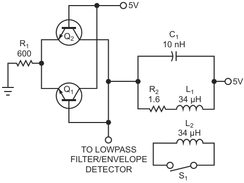

An oscillator generates a …
An oscillator generates a stable signal based on the values of L
1
, L
2
, and C
1
Juan Pablo Caram
Broken-coil detector is simple yet robust
Figure 1
12 Kb
Figure 1. An oscillator generates a stable signal based on the values of L
1
, L
2
, and C
1
Figure 2. A lowpass filter changes the oscillator output into an envelope signal
Figure 3. A second-order lowpass filter removes ripple from the envelope detector's output
Figure 4. Comparator IC
6
monitors the voltage across C
6
and activates when the C
6
voltage exceeds a preset value from R
15
