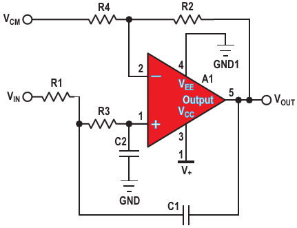

Sallen-Key second-order, single-supply filter. …
Sallen-Key second-order, single-supply filter. The gain of this circuit is 1 +R
2
/R
1
; V
CM
= V+/2

Figure 2. Sallen-Key second-order, single-supply filter. The gain of this circuit is 1 +R
2
/R
1
; V
CM
= V+/2
