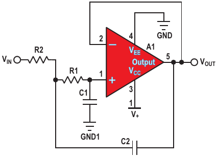

A Sallen-Key second-order, dual-supply, …
A Sallen-Key second-order, dual-supply, low-pass unity gain filter. The gain of this circuit is equal to 1 V/V

Figure 1. MFB second-order single-supply low-pass filter. The gain of this circuit is equal to -R
2
/R
1
; V
CM
= V+/2
Figure 2. Sallen-Key second-order, single-supply filter. The gain of this circuit is 1 +R
2
/R
1
; V
CM
= V+/2
Figure 3. A Sallen-Key second-order, dual-supply, low-pass unity gain filter. The gain of this circuit is equal to 1 V/V
