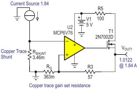

Basic circuit is shown for low-side current sensing with temperature compensated copper PCB trace shunt

Figure 1. Basic circuit is shown for low-side current sensing with temperature compensated copper PCB trace shunt
