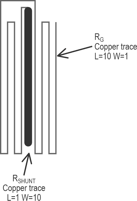

The idea here is to create two resistors with a geometric relationship that will define our gain. For example, consider a high current path (to be called RSHUNT) with the following (normalized) dimensions: length (L) = 1, width (W) = 10. For the gain setting element (to be called RG) create another pattern is L = 10, and W = 1. This gives a dimensional, and therefore resistance, ratio of 100:1. Since the gain resistor is intended to temperature compensate the high current RSHUNT path, it should be located symmetrically and in proximity to the RSHUNT element.

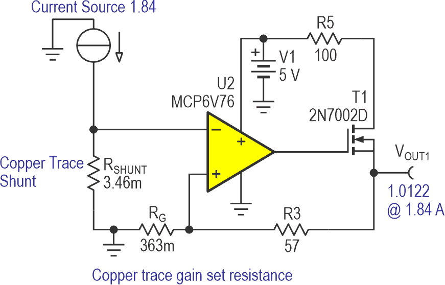

A basic circuit that was used in the initial testing of the concept as illustrated in the simplified schematic (Figure 1). The op amp drives a MOSFET that supplies the feedback current required through the gain resistor, as well as a voltage output proportional to the measured current. This is a basic circuit designed for “low-side sensing” where one terminal of the current shunt is grounded, and the amplifier output is referred to ground.

Also note in the simplified schematic that the current through R3 and RG is always a function of the input current and the ratio of the RSHUNT and RG resistors. The actual values of RSHUNT and RG are only required to have a total value such that the current flow is within the required limit of the current IT1 in MOSFET T1. The ratio of RSHUNT and RG can be determined from:

This current sets a ratio where the output current is a fraction of the input current proportional to the geometric ratio. The voltage at the top of R3 is used as the output and can be varied to adjust gain to any desired value. An example of a circuit board layout depicting the RSHUNT and RG are shown in the low-side current sensing circuit in Figure 2 and Figure 3.
| Figure 3. | Closeup of the test board with a quarter is aimed to indicate actual size. The trace from TP6 to TP7 is the shunt RSHUNT and the trace from TP6 to TP8 is the copper gain resistor RG. The portion covered by the quarter is an unused duplication of the circuit. |
Figure 2 shows a conceptual drawing of ratio matching a copper PCB trace gain resistor to a copper PCB trace shunt to minimize initial errors as well as errors over temperature. The layout of the resistors exploits ratios and interdigitating.

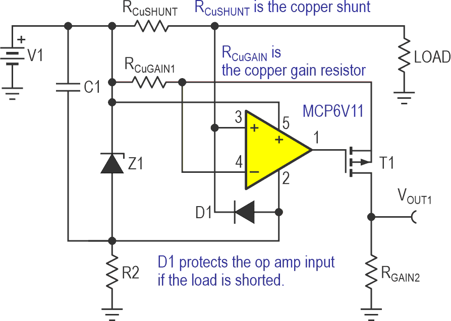

High-side current sensing implementation
A high-side sensing version can be built based on the well known “current drive current sensing” circuit shown in Figure 4.
| Figure 4. | The current drive current sensing circuit is illustrated for high-side sensing. |
The current drive circuit is readily adapted to the trace compensation method where RCuSHUNT and RCuGAIN1 are the PCB traces. RG is a conventional resistor to set to the overall desired gain level. Z1 is a rail-to-rail Zener voltage regulator for the op amp. D1 provides input protection in case the load is shorted.

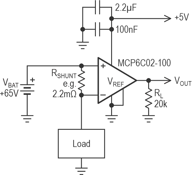

Consider dedicated shunt current sensing
When you implement current sensing on PCB traces, you soon discover why humans invented resistors. Invariably the PCB space required to implement accurate PC trace sensing will require significantly more board area than a shunt.
Keep in mind that the best amplifier offsets are on the order of 5 to 10 µV and decent accuracy begins at full scale voltage drops an order of magnitude above that. By the time you factor in all considerations, you will find that the physically smallest solution will favor the dedicated shunt resistor.
An example is shown in Figure 5 that illustrates simplicity of using dedicated shunt resistors and current sensing amplifiers. The shunt provides a precision resistance along with a low temperature coefficient. Modern zero-drift low offset current sensing amplifiers permit lower shunt voltage drops, which improves efficiency and often permits physically smaller shunts, thanks to lower shunt power dissipation. Unidirectional as well as bi-directional circuits become comparatively painless.
