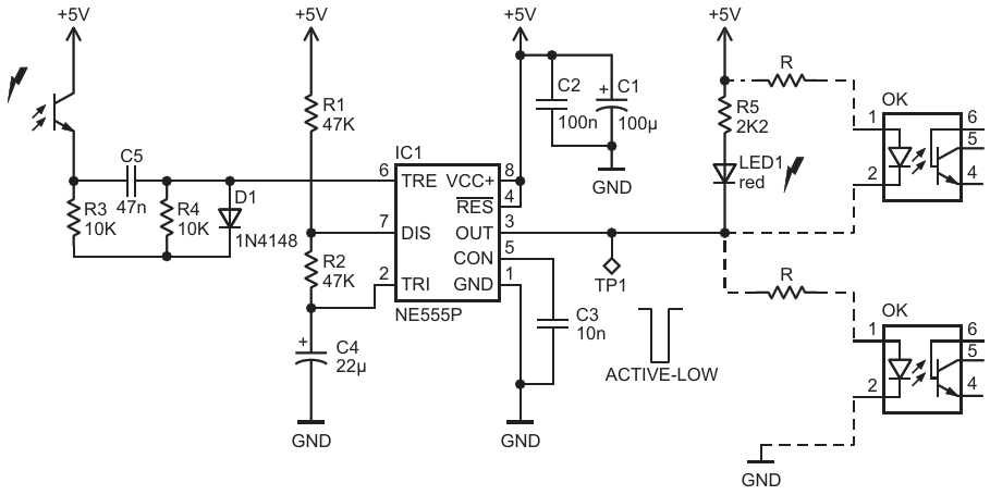

The circuit generates a …
The circuit generates a clean, fixed-duration output pulse in response to a rising edge input

Figure 5. The circuit generates a clean, fixed-duration output pulse in response to a rising edge input
