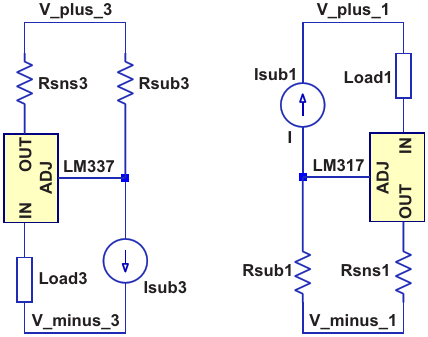

Two independent current sources, one for loads referenced to the more negative voltage, and the other for those to the more positive one. The ISUB current sources control the magnitudes of the currents delivered to the loads

Main DocumentArticle «Improve the accuracy of programmable LM317 and LM337-based power sources»
DescriptionFigure 1
