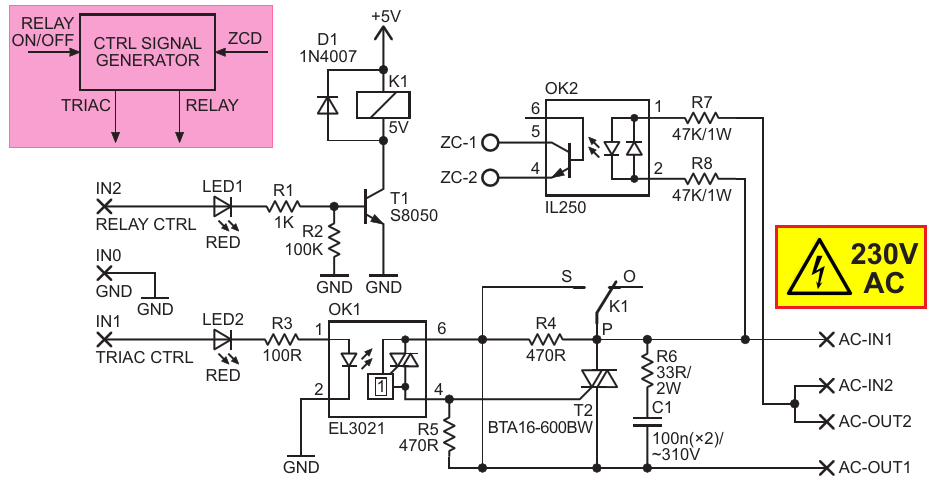

Hybrid relay basics: Why engineers are switching smarter
Figure 3
42 Kb
Figure 1. A simple diagram depicts the basic structure of a hybrid relay
Figure 2. The layout of the G9H hybrid power relay reveals the clever trick employed in its internal design
Figure 3. A minimalistic blueprint of a hands-on hybrid power relay is tailored to ignite the minds of curious makers
