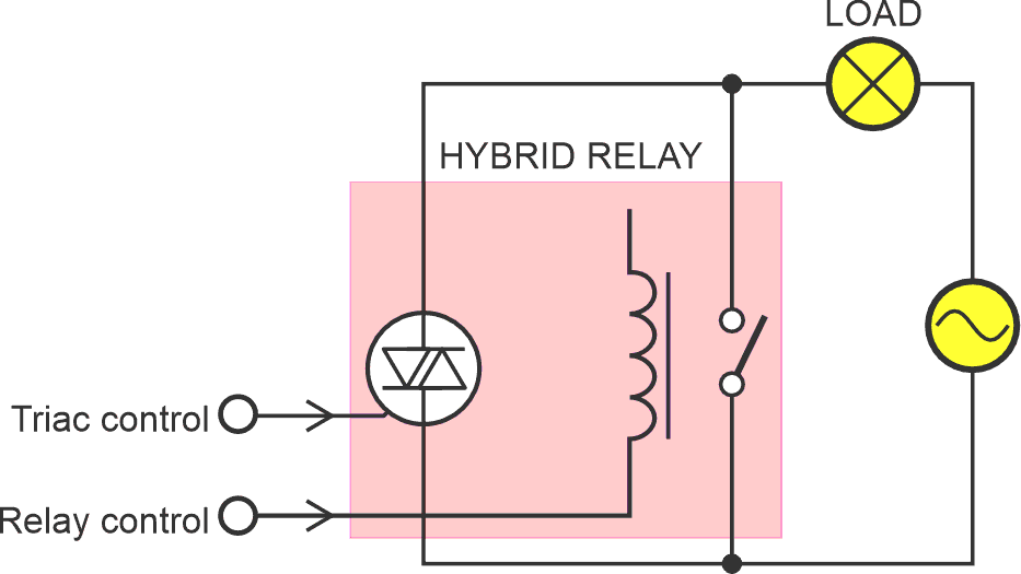

A hybrid relay, which combines a mechanical switch with a solid-state switch, is set up in parallel to control a single load (Figure 1). This configuration unites the robust current-handling capacity of electromechanical relays with the fast, arc-free switching performance of silicon devices.
A simple diagram depicts the basic structure of a hybrid relay.
Figure 1. A simple diagram depicts the basic structure of a hybrid relay.
By harnessing the strengths of both technologies, hybrid relays deliver a reliable and efficient solution for load control; they are well-suited for applications ranging from industrial automation to DIY electronics.
A hybrid relay fundamentally consists of two switches arranged in parallel to control a single AC load. Typically, this configuration pairs an electromechanical relay (EMR) with a solid-state AC switch – such as a triac – operating in tandem.
Initially, the triac is turned ON, allowing line voltage to be applied to the load (start phase). After a few cycles, the electromechanical relay is also activated. At this state, current begins flowing through the mechanical switch, which offers lower resistivity compared to a silicon device. The triac is then turned OFF, and the load current continues exclusively through the relay. This transition reduces power losses during the conduction phase, leveraging the efficiency of the mechanical path.
During the stop phase, the triac is once again activated. However, due to the relay’s low resistivity, current continues to flow through the mechanical switch. The relay is then turned OFF, redirecting the current through the triac.
This ensures that the voltage across the hybrid relay remains low as the mechanical contacts open, effectively preventing arcing or flashes. Finally, the triac is turned OFF. Owing to its latching structure, current continues to flow until the next zero-crossing point, completing the transition safely.

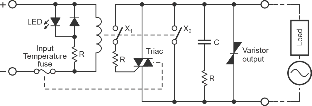

Further, Figure 2 shows the connection layout of the rather unconventional Omron G9H hybrid power relay. This relay uniquely combines an electromechanical relay (EMR) and a solid-state relay (SSR), leveraging a triac to control circuit switching. The hybrid design minimizes contact chattering and arcing during operation.
The layout of the G9H hybrid power relay reveals the clever trick employed in its internal design.
Figure 2. The layout of the G9H hybrid power relay reveals the clever trick employed in its internal design.
The term unconventional is used deliberately, as the design employs a clever trick that dramatically simplifies the overall architecture; namely, the use of auxiliary contacts arranged to operate slightly out of phase with the main contacts.
What sets it apart is that the operation begins when the auxiliary contacts (X1) close, triggering the triac to conduct. After a brief delay, the main contacts (X2) close and take over the full load current. With the voltage across it nearly zero, the triac turns off. When coil voltage is removed, the main contacts open first, allowing the triac to momentarily resume conduction until the load voltage falls to zero. The triac then turns off, completing the switching cycle.

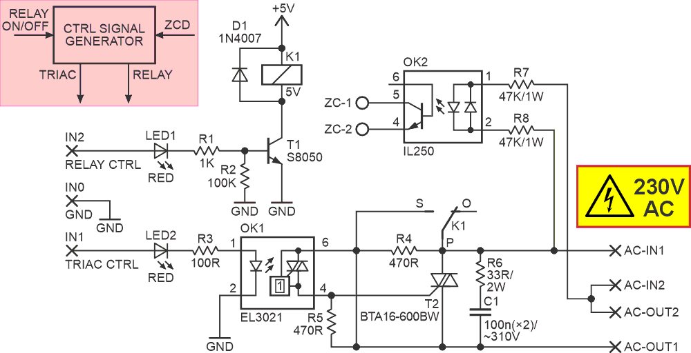

Figure 3 is a simplified blueprint to kickstart your DIY hybrid power relay project.
A minimalistic blueprint of a hands-on hybrid power relay is tailored to ignite the minds of curious makers.
Figure 3. A minimalistic blueprint of a hands-on hybrid power relay is tailored to ignite the minds of curious makers.
Make sure your zero-crossing friendly hybrid relay control signal generator circuitry (see inset) is configured to control the triac, allowing it to pre-switch and post-switch the load for 5–10 milliseconds around each mechanical switch transition. And as you are likely aware, commercial hybrid power relays typically incorporate an ASIC to handle timing functions.
But that is not always necessary for entry-level projects. You can usually get by with a more straightforward approach; in those cases, simplicity often wins. I will probably sketch something soon – but until then, I am curious to see your spin on it.
