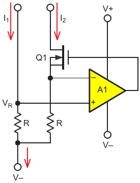

An active current sink mirror. Assuming resistor equality and negligible A1 offset error, A1 feedback forces Q1 to maintain accurate current sink I/O equality I2 = I1

An active current sink mirror Assuming resistor equality and negligible A1 offset error, A1 feedback forces Q1 to maintain accurate current sink I/O equality I sub 2  /sub = I sub 1 /sub
