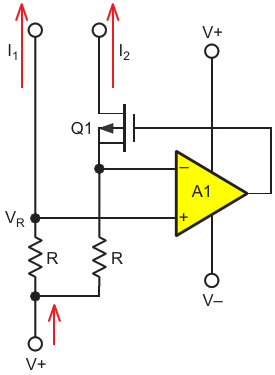

An active current source …
An active current source mirror. This is identical to Figure 1, except this Q1 is a PFET and the polarities are swapped

Figure 1. An active current sink mirror. Assuming resistor equality and negligible A1 offset error, A1 feedback forces Q1 to maintain accurate current sink I/O equality I

Figure 2. An active current source mirror. This is identical to Figure 1, except this Q1 is a PFET and the polarities are swapped
Figure 3. If adequately accurate resistors aren't handy, a trimmer pot might be useful for post-assembly trimming
