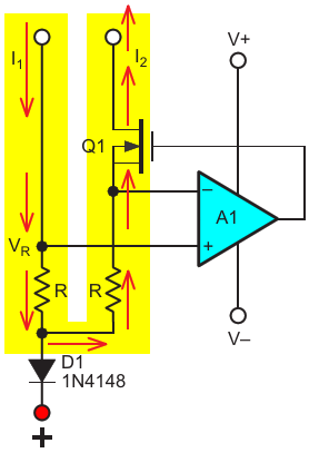

ATWCM in transmission mode. A reverse-biased D1 means I1 has nowhere to go except through the resistors and (saturated and inverted) Q1, where it is transmitted back out as I2

ATWCM in transmission mode A reverse-biased D1 means I sub 1 /sub  has nowhere to go except through the resistors and (saturated and inverted) Q1, where it is transmitted back out as I sub 2 /sub
