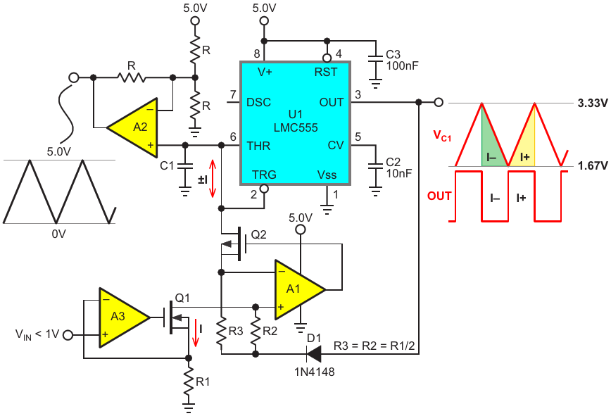

Accurately symmetrical tri-wave and …
Accurately symmetrical tri-wave and square-wave result from inherent A1Q2 two-way mirror symmetry

Figure 1. The active two-way current sink/source mirror. The input current source is mirrored as a sink current when D1 is forward biased, and transmitted as a source current when D1 is reverse biased
Figure 2. ATWCM in mirror mode, I
1
sink current generates V
R
, forcing A1 to coax Q1 to mirror I
2
= I
1
Figure 3. ATWCM in transmission mode. A reverse-biased D1 means I
1
has nowhere to go except through the resistors and (saturated and inverted) Q1, where it is transmitted back out as I
2
Figure 4. Source/sink two-way mirror with a D1 flipped the opposite direction, and Q1 replaced with a PFET
Figure 5. Accurately symmetrical tri-wave and square-wave result from inherent A1Q2 two-way mirror symmetry
