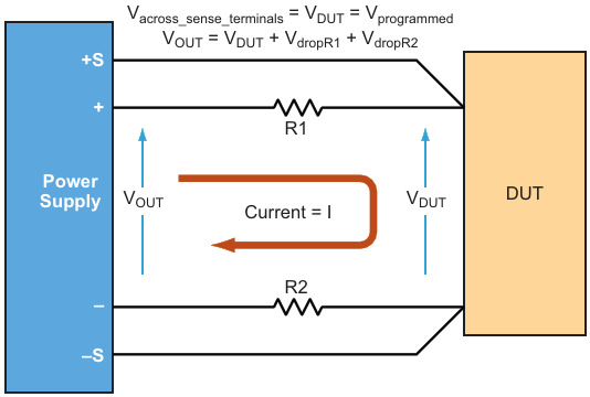

Using remote sensing, voltage …
Using remote sensing, voltage drops in load leads are compensated out so that the voltage at the DUT is the programmed voltage of the power supply

Figure 1. Using remote sensing, voltage drops in load leads are compensated out so that the voltage at the DUT is the programmed voltage of the power supply
