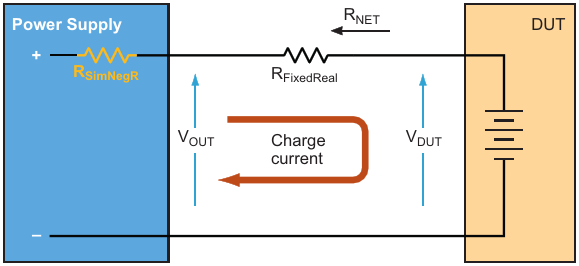

Simulating the negative resistor …
Simulating the negative resistor R
SimNegR
results in R
NET
= R
FixedReal
+ R
SimNegR

Generating negative resistance
Figure 1. Using remote sensing, voltage drops in load leads are compensated out so that the voltage at the DUT is the programmed voltage of the power supply
Figure 2. In this battery test setup, the power supply slowly charges the battery through a fixed resistor R
FixedReal
Figure 3. Simulating the negative resistor R
SimNegR
results in R
NET
= R
FixedReal
+ R
SimNegR
