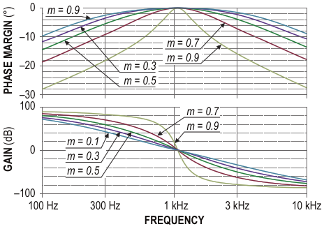

Magnitude and phase Bode plots at the bandpass output, V
OUT
(t), show effects of varying twin-T-cell feedback factor, m, from 0.1 to 0.9

Figure 3. Magnitude and phase Bode plots at the bandpass output, V
OUT
