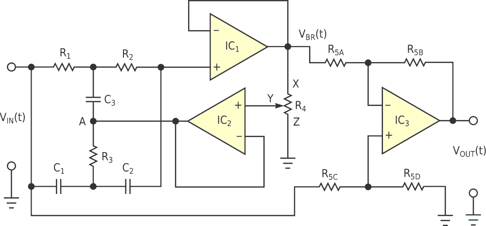

This bandpass active filter features adjustable Q and maximum gain in the passband and consists of a twin-T cell with Q adjustment and a differential output stage. You can also extract a frequency-notch output from the voltage-follower stage.
Figure 1. This bandpass active filter features adjustable Q and maximum gain in the passband and consists of a twin-T cell with Q adjustment
This Design Idea describes a filter structure in which K is inversely proportional to Q. Altering Q also modifies K, producing a magnitude-plot set in which the curves maintain the same maximum gain at the central frequency ω0 – that is, KQ remains constant. Figure 1 shows the filter, which comprises a twin T cell with an adjustable quality factor and a differential stage. The differential stage comprises op amp IC3 and resistors R5A through R5D. This stage outputs the difference between the filter's input signal and the twin-T network's output. Capacitors C1 and C2 are of equal value, C = C1 = C2, capacitor C3 equals 2C, resistors R1 and R2 are also equal and of value R = R1 = R2, and R3 equals R/2. Equation 2 describes the twin-T circuit's transfer-function response as a notch filter producing output VBR(t):

where m represents the twin-T cell's feedback factor. If you designate RXY as the resistance potentiometer R4's upper terminal, Point X; the rotor as Point Y; and RYZ as the resistance between the rotor and the bottom terminal, Point Z, you can express m as the quotient of Equation 4:
  (4)

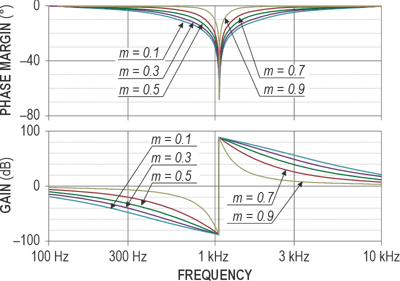

Magnitude and phase Bode plots at the frequency-notch output, VBR(t), show effects of varying twin-T-cell feedback factor, m, from 0.1 to 0.9.
Figure 2. Magnitude and phase Bode plots at the frequency-notch output, VBR(t),

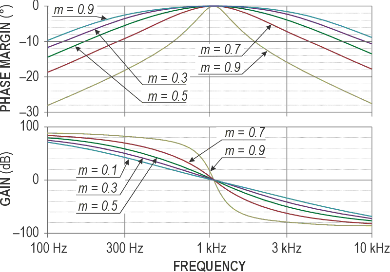

Figure 2 shows the filter's magnitude and phase Bode plots for the frequency-notch output VBR(t) (available at IC1 's output) for values of m from 0.1 to 0.9. Figure 3 shows Bode plots for the filter's bandpass output, VOUT(t), for the same values of m. In both graphs, frequency f0 equals 1061 Hz. To minimize frequency-response variations and improve response accuracy, you can build the filter with precision metal-film resistors of 1% or better tolerance. Likewise, use close-tolerance mica, polycarbonate, polyester, polystyrene, polypropylene, or Teflon capacitors. For best performance, avoid carbon resistors and electrolytic, tantalum, or ceramic capacitors.
Magnitude and phase Bode plots at the bandpass output, VOUT(t), show effects of varying twin-T-cell feedback factor, m, from 0.1 to 0.9.
Figure 3. Magnitude and phase Bode plots at the bandpass output, VOUT(t),
