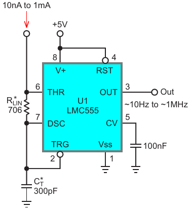

Nonlinearity compensation for 555 internal delays when R

Figure 1. A super simple, 5-decade LMC555 current-controlled oscillator
Figure 2. Nonlinear red curve versus ideal black shows ~20% error from LMC555 internal delay. The y-axis is the output frequency. The x-axis is the control current
Figure 3. Nonlinearity compensation for 555 internal delays when R

D
= 212 ns
Figure 4. Frequency of oscillation nonlinearity is foregone and forgotten if R
LIN
= T
D
/C
T
= 212 ns/300 pF = 706 ohms
