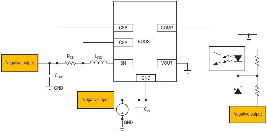

How to generate a regulated negative output from a negative input using a boost controller
Figure 5
13 Kb
Figure 1. This simplified, standard buck controller schematic resembles that of a negative-input, negative-output topology
Figure 2. This simplified schematic details a negative-input negative-output buck controller
Figure 3. This simplified schematic showcases Texas Instruments' LM5155 boost controller
Figure 4. This boost converter block diagram includes the switches' connections to the integrated circuit pins
Figure 5. This simplified schematic employs the boost converter shown earlier
