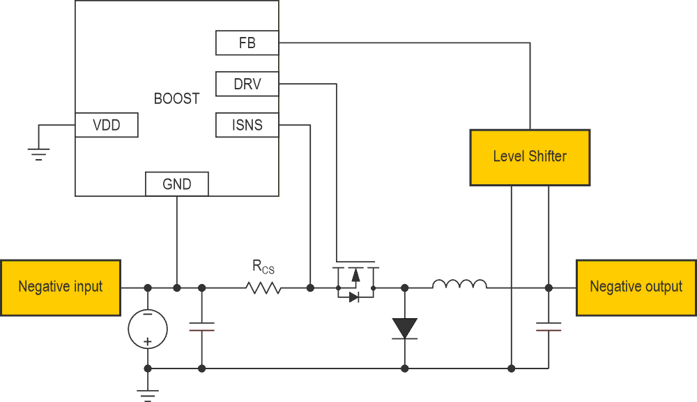

However, a boost controller works if you connect the GND pin to the negative input – a necessary step because otherwise all internal signals would be negative, creating a problem. Another reason is that a boost controller uses a ground-referred gate driver.
Connecting the GND pin to the input voltage allows you to drive the FET without additional circuitry.
Using a nonsynchronous boost controller as a negative-input, negative-output buck controller
Figure 3 shows an example schematic using the Texas Instruments (TI) nonsynchronous boost controller to drive the main FET of a negative-input, negative-output buck controller.
This simplified schematic showcases Texas Instruments' LM5155 boost controller.
Figure 3. This simplified schematic showcases Texas Instruments’ LM5155 boost controller.
Because –VIN is connected to the GND pin, all internal signals reference –VIN. Since –VIN typically varies across an input voltage range, this behavior can cause difficulties when enabling or disabling the device, regulating the output, or other protection features. Typically, you will need a level shifter (for example, an isolated type or one with bipolar FETs) to regulate the negative output voltage.

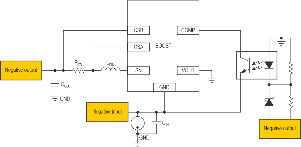

The challenge in using a converter is that many signals are internal. Some ICs integrate the output voltage divider, which makes regulating a negative output voltage difficult. Because all internal voltages reference the negative input, the output voltage would follow the input voltage. In that case, you can use the COMP output instead of the internal feedback. Connecting an optocoupler as a level shifter between COMP and GND provides one method to regulate the negative output.
Figure 5 shows how to connect a boost converter to a negative-input, negative-output buck power stage. The GND pin connects to the negative input, and the VOUT pin (or FB pin) connects to power-stage ground. You can short the FB pin and use the COMP pin with an optocoupler to regulate the output. Keep all voltages, including current-sense signals, below the maximum limits of the boost converter.
This simplified schematic employs the boost converter shown earlier.
Figure 5. This simplified schematic employs the boost converter shown earlier.
