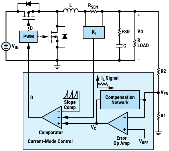

A simplified schematic demonstrating the basic operation of buck converters and their feedback system. This diagram can be found in application note (

Figure 1. A simplified schematic demonstrating the basic operation of buck converters and their feedback system. This diagram can be found in application note (
