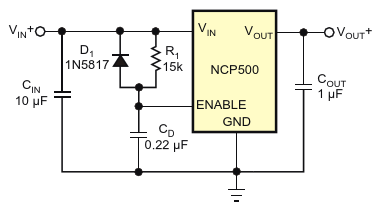

An alternative to directly connecting the regulator's input and enable pins, this "conventional" modification uses a resistor and a capacitor to delay the regulator's turn-on time. The diode eliminates the powerdown delay interval
AuthorsWilliam Lepkowski
Main DocumentArticle «Low-dropout linear regulators double as voltage-supervisor circuits»
DescriptionFigure 2
File Format / SizePDF / 14 Kb
An alternative to directly connecting the regulator's input and enable pins, this "conventional" modification uses a resistor and a capacitor to delay the regulator's turn-on time The diode eliminates the powerdown delay interval
