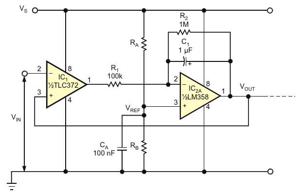

For operation from a single power supply, this version of the peak detector sets a reference voltage via resistors RA and RB

Figure 4. For operation from a single power supply, this version of the peak detector sets a reference voltage via resistors RA and RB
