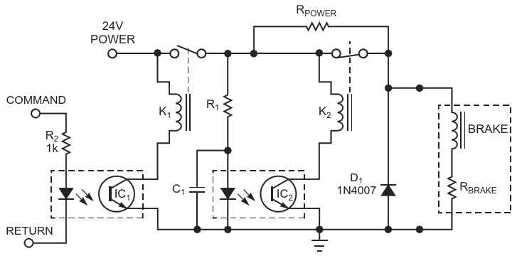

Actuating the brake release trips relay K1 and applies 24 V to the brake. An RC network delays K2's actuation. When normally closed relay K2 opens, resistor RPOWER reduces the voltage applied to the brake to the

Main DocumentArticle «Switching regulator reduces motor brake's power consumption»
DescriptionFigure 2
