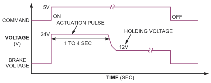

After the actuation pulse …
After the actuation pulse applies full voltage to the brake, the regulator's output gradually decreases to the nominal holding voltage

Figure 4. After the actuation pulse applies full voltage to the brake, the regulator's output gradually decreases to the nominal holding voltage
