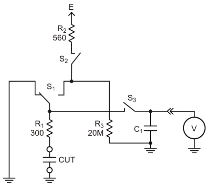

This circuit can measure …
This circuit can measure dielectric absorption for a capacitor under test by properly controlling the timing of the reed relay switches
Peter Demchenko
Quickly estimate capacitor dielectric absorption
Figure 1
11 Kb
Figure 1. This circuit can measure dielectric absorption for a capacitor under test by properly controlling the timing of the reed relay switches
