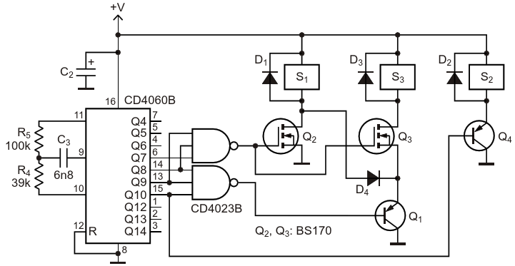

Figure 1. This circuit can measure dielectric absorption for a capacitor under test by properly controlling the timing of the reed relay switches
Figure 2. To control the switches in the circuit of Figure 1, a timer activates relay drivers
Figure 3. This is the timing sequence generated by the circuit in Figure 2
