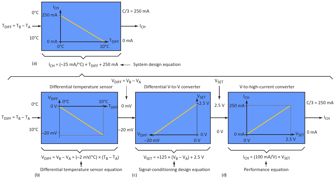

These graphs and equations represent the battery-protection circuit's operation, including the overall design (a), the temperature sensor circuitry (b), the differential-voltage-to-voltage converter (c), and the voltage-to-high-current converter (d)
AuthorsJoseph Diecidue
Main DocumentArticle ««Intelligent» NiCd Charger Avoids Battery Damage From High Currents»
DescriptionFigure 1
File Format / SizePDF / 35 Kb
